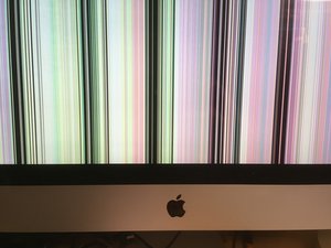

I’m having a screen/display issue which occurs immediately when my iMac is powered on.
It's a late 2009 21.5 inch model, MC413LL/A with the ATI Radeon HD 4670.
Immediately after the Chime sound, this screen
is shown, after 10 seconds shown with an Apple logo,
and within one minute followed by this one:
And there seems to be no activity after a minute. I cannot login, but the iMac is accessible from the network. The login screen does not seem to appear.
I however can boot into the recovery mode and then see the "proper" screen, but with distorting vertical lines on it.
I attached an external monitor which also presents the vertical lines, so it is a Video card issue, not a display issue.

This seemed to be a good moment to upgrade my iMac with an SSD, and last weekend I opened it up again, removed the display and replaced the DVD with the SSD, and put the LCD back into the system again. And guess what, the screen issue as displayed on the attached pictures occurred again. I reconnected the display (data) connectors about 5 times, but the problem remains.
So, the GPU card worked at the repair service and I have also seen it working after reassembling the iMac, but on this moment the primary problem occurs again. I’m having the idea all electronic parts are functioning properly and it’s some kind of connector issue.
Could it be the video card connector (to the logic board) that is causing this problem? In another thread I found it could possibly be corrosion on the connector. I already removed the video card and cleaned the connection using Kontakt 60 contact spray, but that did not help.

I managed to solve the displaying issue. As it seemed to be a video card issue, and the connector did not seem to be the problem, I finally tried the process of re-flowing the solder of the video card by baking the video card in the oven. Yes! The card is repaired by puting it in the oven for 8 minutes at 190 degrees celsius, after removing all stuff from it that can melt (thermal paste, rubber). It is described on many forums on the internet and also here:
Temporarily Repair a Lost Cause Graphics Card by Heating it up in an oven
After assembling the iMac, the screen is functioning great again.

I had the same stripy pixelated thing on a fixer upper. Also suspected the logic board or graphic card. But I was wrong: When I booted it holding D to do the hard ware test, my monitor was showing no lines. I aborted the test, and booted from another external HDD, and it came up without the pixelated stripes. So I used that boot up to erase the build in HDD, which by the way had been maxed out, restored that HDD with a fresh OSX, and voila....no more stripes. My conclusion: Always fix the most likely component to fail: the HDD.

@imacpain1 rich, I would say that the fix I found is still working: I did send in the GPU and had it repaired in California, by http://stores.ebay.ca/brickfence.
Not just a reflow, but had a new chip installed on the GPU, came to about US$ 140.
Update: The restored HDD did NOT fix this in the long run. Back to replacing the video controller. Is that integrated on the logic board, or is it separate, does anyone know?

Hi YpeH, thank you for the heads up. I just removed the ATI card yesterday and I will be shipping it to a repair service in California, who will do a proper job including "reballing" (whatever that means...) for $100.
After that I needed to replace the HDD as well. Since this model is very touchy about what HDD it wants, I needed to order a conversion kit for about US$40, so it now allows any old HDD, including even 2.5" SSD. This concludes my fix, she is up and running smartly now, for hopefully another decade.
