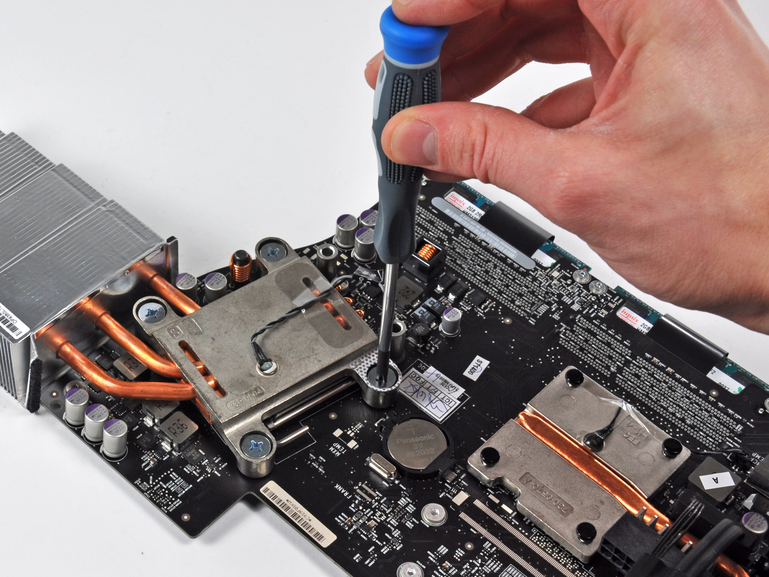

I'd appreciate any hints to find a replacement for the video card for my iMac.
Screen shows a checkerboard pattern, however I'am able to ssh the machine remotely without any problems.

Can you supply us the last three digits of your serial number so we can correctly identify your system as you have conflicting information here. Is one of these your system?
Thanks Dan, herewith last 3 digits of serial number: B9U
As per "About this Mac" info my machine has the ATI Radeon HD 4670 256 MB video card, however I am not sure if it can be replaced or if it is soldered to the "Logic board" therefore requiring the full board replacement?
Appreciate your advise ( as well from the iFixIt community)
All the best.
Your system is: iMac "Core 2 Duo" 3.06 21.5" (Late '09) 3.06 GHz Core 2 Duo (E7600)
Thanks again Dan, would you know if Video Card itself can be replaced? or taking the opportunity it is already damaged, maybe even upgrade it, would you know any upgrade to it?
The system is marked on the foot as EMC 2551, which is not a known system in Apples line up. By looking up by serial number and using the firmware rev info iMac10,1 the system is in fact a EMC 2308.
Do you have an external display that you can attach to your system? Give it a try to see if the display is gone or the or the LDVS cable has a problem Vs the GPU.
Sorry to say you'll need to replace the entire logic board if the GPU is bad as the GPU is soldered directly on the logic board.

The iMacs are a cross between a laptop and a desktop architecturally internally. The older models did have a replaceable graphics board as Apple moved forward they dropped the sub assembly board and integrated the graphics GPU and support chips directly onto the main board (your system). The GPU is soldered onto the logic board (it's not in a socket) as such you can't replace it. Here's a good picture of the CPU & GPU The person is removing the screws from the CPU heat sink, the GPU is the other chip.

First, from your serial number you don't have a EMC-2551 system you have this one: EMC-2308. Yes, Apple did use a sub assembly and the links you provided are those sub assembles. But, they are for the older model not what you have. Which is why I pasted a picture of your exact logic board so you could see it was not on a sub assembly. Apple does buy ATI Radeon GPU's which they mount onto the logic board (just like the laptops).
