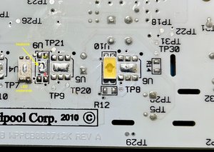

I had the same problem and upon inspecting the board I discovered R15 on the board was totally corroded and as soon I tried cleaning it, it came right off the board. I was able to remove it, clean it and solder it back on. Problem was solved immediately. So inspeat your board and if you have soldering skills you can repair it yourself.

The board is part of the led (main light) or the right side of the fridge. It comes right off. Open fridge and use flathead to release the tabs holding it. Then disconnect the two cables attached to it. Inspect R15 and R17 for any rust. If you can have a local repair shop solder it cheap it heats having to buy a new one. If you can't just order another online.
Thank you DJ AB! What resistor value is R15, or can you read the code on it. I plan to replace it as mine is burned off the board. R17 is 910 which is 91 ohm +/-5%.
My board had same problem R15 burned out .I can fix it ,but I donot know the value of R15. Somebody can tell me? thanks
i belive r15 is the same as r17

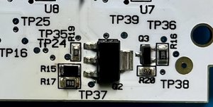

Thank you for that part number. Everyone says resolder R-15 which I did but why did this resistor look damaged to begin with? Perhaps the modules down line of it are drawing too much power through this "ant-sized" component. Enough people here have said the R-15 fix does not last. We will see. If mine flickers again, I'll will have the three modules on hand and ready to go 😁

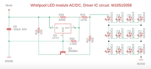

Regarding the question about the correct values of R15 and R17, it appears that they are 91-ohm and 127-ohm, respectively. This information came from the YouTube link below.
https://www.youtube.com/watch?v=OdgzfOHS...
Both R15 and R17 were burnt-out on my board. I removed the resistors from my failed board and measured them: R15=890-ohm, R17=1.7-kOhm. These readings could indicate that the resistors were overheating and degrading over time which increased the resistance as more material was burnt away.
Nice work. I’m an electrical engineer and after a bit of searching I found this solution. You were correct and the fix does work.
I obtained a couple SMT resistors from work of the values you called out and was immediately rewarded with a steady light after replacing the old ones. Unfortunately about a year or two later it’s doing it again.
So I get to replace them again - still a couple pennies for resistors beats the HECK out of around a $200 replacement for what is essentially a glorified lamp.
The problem stems from the fact the circuit was improperly designed. The resistors simply do not have the proper wattage rating to handle the power going through them and consequently, as you mentioned, begin to burn out. This changes their value to a much higher value than nominal and causes the malfunction you see. (The strobing.)

Scott, can you confirm the values for R15/17?
@cliff_barnes Sorry I never saw your question for some reason so I’m six months late but it’s 127 ohms for R15 and 91 ohms for R17.
I’m sorry I can’t remember if the physical package size was 0805 or 0603 but they are both dirt cheap so I’d just get both sizes to be safe. 1210 even if you can get them to fit,

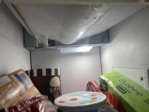

There is a trick to this! The lower refrigerator light and the freezer light are run in series back to the main top light. For the main top light connect the neutral (white) to the red going to the slaves. Connect the main hot (solid yellow) to the striped yellow running to the slaves. Then connect each of these two leads to the new LED light in the top. Connect a new LED to the two leads in the bottom of the refrigerator (red and gray). The freezer is trickier… Connect BOTH leads in the freezer light together! Then run a wire to the ground in the wiring harness just behind the freezer light (it’s just 4 bolts, so don’t panic). Then connect this new ground wire (now a neutral) to one side of a new LED, and connect both of the original leads (now connected together) to the other side of the LED.
If you used the parts I did it fits nicely behind the original plates with the old LED boards removed. You will need butt connectors, crimpers, and electrical tape for good measure. I actually wired two new LED bulbs in the top main area just for extra brightness. If you follow this exactly it will work! The g8 bases are optional, but will allow you to change out the bulbs easily IF they ever go bad.
All this to say that Whirlpool should have corrected this for us, and I’m in if there is a lawsuit. Problem solved for less than $30. Couldn’t be happier after dealing with this for three years! Reach out if you need more info!

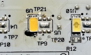

I had this issue with my Whirlpool and it looks like the referenced resistors were compromised. I'm so glad i found this thread. I used the instructions from sethgrant and it worked! I put two lights in the top of the fridge and one on the bottom. After doing this, the original freezer light worked (though a little dimmer) so i'm not even going to bother replacing freezer light. I kind of can't believe i was able to do this wiring, but it worked great.

the attached picture goes with my comment above regarding sethgrant's solution.

Used 1206 1/4W (R15 in pic) and worked but slightly bigger than original which is probably 0805 (R17). Note I have a hot air station to solder on the bigger resistor. If soldering iron probably can't get heat on the solder so best go with 0805
Dead LED
Also found a dead LED (5630 3v) on W10515057 board. Couldn't find the matching + - pattern replacement so soldered masked off one - and soldered on a standard LED with + - on either end.
Used hot air station to solder on the heat sink contact under the LED. Probably not possible with soldering iron
Conformal Coating
Put on conformal coating (over the resistor and around the LED) to seal off moisture. Lets see how long these fixes last :)

ANOTHER PROBLEM ON SAME MODEL refrigerator is the defrosting DRAIN TUBE that goes down to catch-pan (to naturally evaporate) gets CLOGGED, thus causing water to back up and FREEZE all the way back up to the coils, thus DROPPING COOLING ABILITY DOWN TO NEXT TO NOTHING! You might noticed a SHEET OF ICE on bottom portion of freezer side when this happens as well. SOLUTION: removing rectangular bottom panel (usually cardboard believe it or not) on back of unit, then look in and up inside the freezer side for a small 4 inch black or white plastic curved tube, remove it's one attaching screw....flush out tube with hose/ water pressure, reinstall.....WELLA! Problem SOLVED !
I wish I had seen this one.week ago, before calling a repair company. That's exactly what has happened next with this model. This same repairman warned that the next thing to go will most likely be the wster.filter door or housing will go. I also had to replace he ice maker once, and lights 2 times!!!
