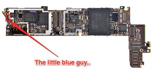

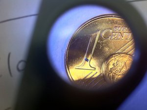

Yep, that's the one dianthabrazzell - I had the same problem, noticed that the (very very tiny) fuse (or resistor?) was loose and when I inspected, it fell off.. (I still have it) but I used a very strong magnifying glass and a soldering iron to reconnect.. Wasn't easy.. The Circuit Writer Pen sounds handy for jobs like that.. so once I reconnected it I got my 3g back.. I think it was even a little better than before.. not sure what that component does but at least it's not essential..
Update
..apparently, it's an inductor?
yep, it is:-) +1 great answer
Thanks, worked for me! I had the "no service" problem on iPhone 4 after some repairs. Apparently the blue inductor had gone missing. So the wifi worked but there was no cellular network or it was very very weak. I just soldered the two points together and now it works. It was not an easy job since my solder tip is quite big. I used one leg of resistor and coiled it around my soldering tip and used that to put the tiny solder tin on place.

you can get that little blue inductor coil new here
it is more than likely the little blue antenna coil (no more than 1mm in size) highlighted in the photo in the previous answer. this happened to an idiot "friend of mine" who changed his screen with the instructions on this site (ok it was me).
perfect instructions to change the screen from this site but didn't see any advice about just how fragile that coil is. so after pulling apart my phone and reassembling it four times (was jipped into just buying the digitiser screen before realising you need that and the lcd as the lcd doesn't detach, then getting a faulty part) i knocked the coil off.
if you aren't electronics savvy and aren't confident of putting in a new one yourself you can do what i did.
i used a circuit pen and put a tiny dab of conductive silver bridging the connecting points where the coil are and now the phone has perfect reception again (actually seems stronger than before). you can get one of these pens from any hobby electronics store.
