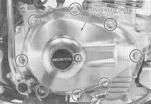

Drain all oil from the engine
Remove the torque converter case

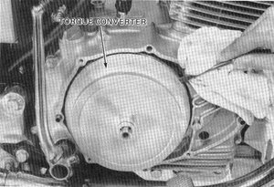

Remove the torque converter by applying a screwdriver blade to the groove in its periphery
NOTE: Use care not to damage the gasket surface of the crankcase.

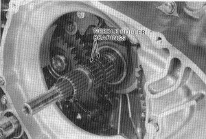

REmove the needle roller bearings. Check them for wear, damage or other defects.

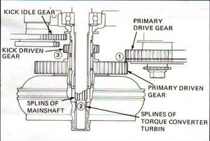

Install the torque converter in the following sequence:
  1. Engage the primary driven and drive gears together.
  2. Set the transmission in 1st or 2nd gear, then align teh splines of the main shaft with those of the torque converter turbine by rotating the rear wheel by hand.
  3. Engage the kick starter driver gear with the kick idle gear while operating the kick pedal slowly.

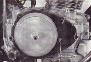

Place the gasket on the crankcase, then press the two dowel pins into their respective positions.
Note:
  • Check that the torque converter check valve is installed.
  • Clean all passages in the torque converter case in/with solvent before installation
