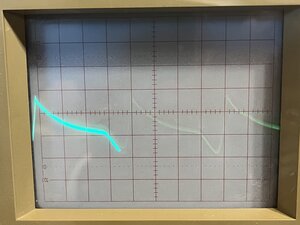

Since the supply measured ok I turned to the internet and went down several rabbit holes with no luck. Still wondering about the power supply I decided to get my scope out and have a look at both supplies. As it turned out both supplies had almost 2 volts of 60 Hz ripple on them.
Scope set to 500mv per division.

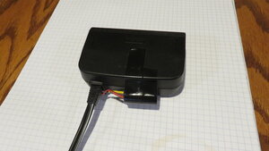

I then opened the power supply after buying a gamebit screwdriver on Amazon.
https://www.amazon.ca/Screwdriver-Rojuna...
I noticed the capacitor on the line side of the supply was slightly bulged. This cap is right up against the heatsink for the switching transistor so I suspect it got cooked over time. I bet this is a common failure.
It's not a very common cap as it's a high voltage, high temperature cap in a low profile package. I wasn't able to find one locally so I used what I had. It was a bit of an emergency since my grandkids were here from the other side of the country.
I ran the wires out through the line cord opening to avoid drilling holes in the case. The correct part to order from DigiKey is here. https://www.digikey.ca/en/products/detai...
Hopefully this will help anyone with an N64 that is continuously resetting.
