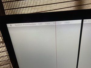

I've got vertical lines on my iMac 27" screen
After I opened it to replace the HDD I got vertical lines, after return from an authorized Apple they return even more problematic, they said that the LCD was damaged, but I just open as I do always, I thought that is the cable/connector.
Has anybody pass thought the same problem?

Here the screen photo

Sounds like a TAB error. Post an image of what your screen looks like with your question for confirmation.
If the lines disappear when you apply pressure on the upper vertical edge of the LCD, where the tabs are bonded, you know that the bond has failed. There is really not much of an DIY fix for it.

The newer 'Thin Series' systems are much harder to open without damaging the LCD panel. One needs to have the correct tools and take ones time. You need to follow the IFIXT guide iMac Intel 27" EMC 2546 Display Replacement on where to pry and you mustn't pry to hard as that is the root issue on why people kill their displays.
I killed my first one too so don't kick your self to hard here.

While this vid is about LCD TV's the same issues apply to computer displays: LCD Display problems. The problem you are facing is the damage along the edge on the backside you nicked the fine contacts that tie into the driver logic.

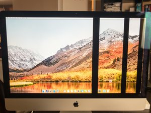

I know this is a very old thread but I believe I have solved the mystery. I purchased a used 27 iMac 5k with 3 black lines on the right hoping I could fix it. I tried everything to figure out why it was bad, GPU, cables, cable connectors, etc. I've also read every question on this topic on this site. It was not until I removed the metal shield on the top rear of the LCD that I saw that it had several cable ribbons from the long PCB connected to the screen. At first I thought the leads were bad, but upon closer inspection I noticed three of the ribbon cables were cut. 3 black lines on the right. 3 ribbon cables cut on the right. It appears that when the last person tried to get into this, they may have used a sharp blade or razor to cut the adhesive. In doing so they sliced too deep and cut into the ribbons! I don't know if the ribbons can be replaced or the rear PCB. I have never seen it sold anywhere and the soldering is so fine it can't be done by hand. :(
See pics:

You'll need to replace the display assembly crwdns2937315:0IF174-035crwdne2937315:0

To add a bit more context here: Note how you have sharp bands unlike the OP's display.
There are three distinct ways you can damage the display
● Prying which damages discreet lines which is what the OP encountered often creates a fine line
● Tearing away the ribbon cable from the LCD panel by snagging it, creating a wide line
● Cutting too deep which is what your system faced causing a wide black strip
All of which gets down to using the correct tools and technique!

The cable yingwang01 is talking about is the ribbon cables which attach directly to the LCD glass panel. In the process of taking the display off the person slid a knife deeply and it went to far slicing it! This is not repairable!
The issue the original OP had was exactly what happened to me! The first time I tried servicing the newer 2012 iMac's back then we had nothing to work off of like we do today. I had pressed to hard damaging the same cables but unlike yingwang01 system I only damaged a few lines (10 at most) Vs the 50 or so the knife cut through.
In your case the thin line is like what happened to me and the larger one is where you may have snagged the ribbon pulling it free from the LCD panel its self.
Don't take my word for it! Prove it to your self! Take the display off and then remove the cover plate as yingwang01 described. If you look carefully you'll see the damaged ribbon cables.
In the end you need a new display assembly to fix this.
