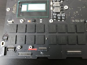

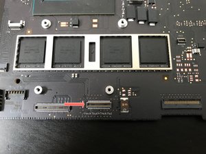

The A1502 without force touch uses a ribbon cable and the A1502 with force touch uses a socket to connect the track pad so no you can not.
Hi, and if I have a 2015 A1502 with classic pad, can i change it with Touch Force ? the motherboard seems the same :s
The 2015 A1502 doesn't have a mechanical touch pad, all of them have force touch trackpads. Unless the board inside is a late 2013-2014
