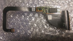

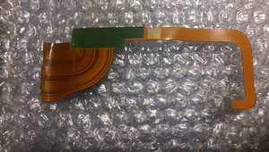

Okay, finally home and installed screen, screen installs great. Digitizer seems to be an incorrect driver/firmware issue. I will post images following this to explain the issue. it seems that with someone else who may have the know-how it could work. I don't know much about hardware ID's and how they work or may be able to be changed/edited
My old digitizer connection.
Okay...
Unless i was given a faulty one, i'm going to have to finalize with the v0.5 will not work. The screen that came with it works great. the digitizer didn't seem to be getting enough power or being completely acknowledged. system restores, driver replacements and new installs.. didn't seem to show anything.

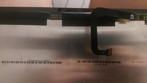

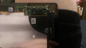

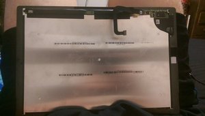

Above i attached photos of the lcd/digi replacement. The lcd seems to work fine.. the digitizer just doesn't seem to acknowledge touch/pen. I was curious if it would be feasible to take the portion other than the digitizer and swap it out but it doesn't look like that would be an easy fix either.
Well done for going out and giving it a try.
Out of curiosity.
Have you
a) done a firmware update (assuming it will allow you)
b) Is it recognized by device manager?
mm strange. i was sure I had seen a firmware download on the Ntrig site before. However I can no longer..
Doesn't seem to really show any special devices.. Not sure what it looks like before the damage. i bought one damaged to fix.
Is it missing something? do you need a picture of some other spot?
Ok. So unless I am mistaken, it has found drives and installed correctly. All be it not functioning. Interesting!

I have installed ver.0.5 on each
Surface pro 3 with original 1.0 screen
Surface pro 3 with original 1.1 screen
After installing the 0.5, you need to factory reset. The digitizer will not be responsive at first, so use a usb mouse.
Run windows updates and check each time for firmware to be listed. Check optional updates and keep checking for more updates even if it says updates completed.
If there's no luck, factory reset again and repeat updates.
I haven't found any patterns thus far but I've got ver 0.5 to work on 1.0 and 1.1 surfaces.
Lucas can you tell me what driver/version or firmware that was installed for your .5 for the 1.1?
Thanks!
Oh and one more thing.
Be sure the supplier of the digitizer is credible and confirms it is a working replacement. The first 3 I bought were defective and thankfully I was able to return. Keep this in mind if you are running into trouble.
Good luck!

I've bought about 5 v0.5 digitizers, only 1 worked normally but with "ghost touches". I had about 4 surface pro 3s to repair and all used v1.1 digitizers.
I've had no success with replacing the digitizers, although the cost that I paid for each LCD Digitizer combo had turned up to be close to the replacement cost microsoft charges! For most people you might be better off with paying microsoft because a dented case can make it troublesome to replace the LCD as well
I suspect anything before v1 is basically preproduction, the people selling v0.5s had dug them out of a bin somewhere and started selling it for a buck.
how could i know what "vX.X" is mine i need to replace
Hi,
I have try few reset and drivers with 0,5. screen and home button ok but touch no life at all.
for microsoft support one of this model are the same. they told me that it can work with all version
i lost the cable has version touch screen, how could i know what "vX.X" is mine i need to replace, tks

I dont suggest replacing the screen yourself, paying Microsoft would be cheaper; replacing with microsoft is about 300 USD
All depends on how confident you are. Once you get the old screen off, it's 20x easier than doing an iPad. Just get some good adhesive because 3m tape just comes off once the Surface gets warm :-/
Maybe but as said many on the market are in my brief experience faulty and given MS charge less for a recon unit than the screen itself why would you go to the trouble of buying from China or HK?
drunkenmenace: Out of interest what tape would you recommend?
Basically the reason I went for the repair myself is because I run a business fixing phone and tablet screens. I hadn't done a surface yet so thought I'd give it a go :) As for tape? I'll have to get back to you as I've not found anything decent as yet :/
