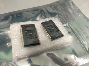

I had the same issue and after trying all the recommendations still no success so the conclusion was that the sensor was dead.
Probably not worth for most but I was able to replace the part and it's working again.
with only a simple soldering iron is a little difficult but, a fun challenge.
You can find the part on Aliexpress, just search for "S7530SLV".

Hi, rodgsilva I have one magic mouse failing, since 2 years was abandoned in a box and I was looking for a fix, I am a electronic enthusiast and I am agree with this advice, left and right click good but no movement in the cursor. I will try this. Thanks for sharing, the Magic Mouse is a great tool!
Wonderful I was searching for this part
Thank you so much for sharing
Im trying this out soon as I am facing the same issue but I can't seem to separate the bulb from the chip itself. Was wondering how you did it. Any suggestions would greatly help out. Thanks
