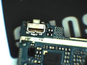

I would bet that this is a power button repair. Most of the time this happens as the solder becomes unstable where the power button is soldered to the logic board.
Here is an image of a power button repair
Here is a link to our power button repair video. https://www.youtube.com/watch?v=qXqPqAsf...
If it is the problem of power button , how the phone become power on again after remove the battery and put it back ??
