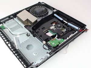

I'm assuming what's pictured is the guard raised to keep the disc in the optical drive when one is inserted.
Utilizing the manual release did not lower it.
Resetting the device in safe mode did not resolve the issue.
Am I correct in assuming this is what keeps the disc in the drive?
Any idea on a manual reset? I can press it down but it pops right back up.
Sorry for the blurry image. If you can make out the black plastic guard that's what I'm referring to.
UPDATE
One of the rollers came out of place which caused the guard to remain up.
New issue - it will not "accept" a disc. I can now insert the disc but it will not auto feed. I can use the manual eject screw to insert/remove the disc but it will not read. I've tried different tightness and it seems to try to spin the disc at a certain point (with lots of noise) but fails to read it.
if the system is powered on with the disc partially inserted the system appears to be cable of ejecting it.* The eject button no longer responds...

I had a similar issue. After taking apart my disk drive to get coins out it would not feed or eject disk. The problem was inside the disk drive the lever to push the slide forward to hold down the rollers and bring the guard up.
If you take the covers off your drive and manually roll a disk in you should see the problem. It is a lever that is pushed by the disk about halfway in. The lever the hits a slide on the side of the drive and pushes into the roller gear which then pulls it over the rollers to hold them down so the disk can spin. It had turned past one of it limits and I just had to force it back.
Hope this helps.
Be sure to manually turn the screw and test it before closing it back up.
That was it! Thank you so much for this! I took a blank CD and kept trying to put it in there and it was getting slight scratches and noticed the little flap was touching one of my rollers. I move the roller back so it could open all the way and the gear turned back with a little bit of force. Thanks!

In the picture you posted the rollers look filthy. Try cleaning the rollers with some alcohol and a microfiber cloth. When they get dirty they can't "grab" the disc. This usually fixes the problem for me. Good luck!
If you're referring to the original pictures those were shadows, not dirt.
The issue was resolved. Roller reset & confirming firm cable connection.

I had a roller come out of location. A white plastic rod was laying inside. Does this connect the two rollers?
yes it does, it twist in-between them
Yes, the white piece goes between the two rollers. If you're unable to see the image in the original post let me know.

The issue was the rollers.
After thinking I realized that if it could eject a disc but not feed one it was only performing half of a function. Meaning a loose connection.
The ribbon cable with the weird connection release apparently controls these functions and was a bit loose.

Same situation happened to me. I reconnected the roller and cross link. Now it is hard to insert disc without a push. Any suggestions?
Your rollers are probably messed up. They need to be nice and smooth or they won't be able to pull the disc in very well. Unfortunately there is no place to buy just the rollers...you might end up needing to replace the entire drive if you want it completely fixed.
Make sure the connector for the disc drive is firmly in place if you're having to force the disc in. I find it unlikely the rollers aren't smooth if nothing damaged them. . .
Just take the roller and white connector out and reset it. Works 90% of the time to clear up "rollers work but have to push" issues

The white thing on the side is proberley your problem, it’s meant to push roller down and up I pulled mine forward to bring up the gaurd that keeps disk in and put a disk in and reset PS4 and now it’s working I find it hard to describe tho so if u message me on Instagram That_Guy3136 I can send photos of it, I broke mine by playing with the cogs under the drive.
I have the issue but the problem isnt my rollers the disc insert/eject sensor is missing a small plastic part that gets tapped when you insert a disc (when it’s tapped by you inserting the disc is causes the rollers to engage) I have ordered the part however I can’t find a single video on the repair anywhere so it looks like it’s gunna be some major guess work coming from me! (PS4 Slim)
I also have the PS4 slim with this problem, i took it all apart and can't find anything wrong. Could you show me exactly where that little plastic piece goes? And what it looks like?
Here’s my experience with this behavior:
I just had this issue on a PS4 Slim, turned out to be dirt jamming up the grooves in the disc roller gears, it was causing the rollers to be sluggish and skip a little but ultimately didn’t have the torque to fully pull the disc in or eject it once forced in, this would also prevent the disc from settling all the way in so that the drive could properly read it. Once I cleaned out the gear connected to the rollers and carefully used a small jewelers flathead screwdriver and a nylon brush to clean the other two gears it works like new. Hope this helps others with this issue.
Turned out to be the back sensor that gets tapped when you insert a disc by the top half of the disc drive had snapped and wasn’t being tapped I believe it was KLD-004 but I can’t remember
