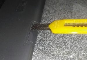

!! BEST WAY TO TAKE OUT BATTERY, WITH NO DAMAGE!!
Follow each step as shown in the pictures.
1. Poke the tip of a razor (or something sharp but thin and rigid) straight into the inside edge.
2. Slide underneath (PARALLEL TO THE BOTTOM).

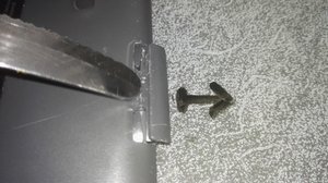

3. Slide the razor almost all the way out and tilt up at 45degrees to lift plastic enough to slide a butter knife in.
4. MAKE SURE YOU ONLY LEAVE ABOUT 3mm OF THE BUTTER KNIFE IN AND LEVER THE PIECE OUT.
5. Once the door is out a little, use the same butter knife to push out with force by resting the edge of the butter knife in one of the grooves.
First: I pushed over on one side ...
Then: I pushed in the middle ...

I used a precision screwdriver and got the exact same results with minimum force!
There is no removal method that does not damage the plastic. I’ve used every one of the supposed no damage methods and they all cause damage to the plastic of both the tray and keyboard.
