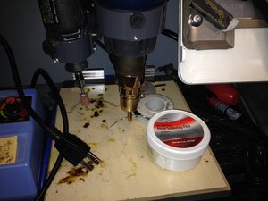

  • Tip, use a heat gun adapter to make much less heat exposure and a piece of card board and or heat gun stand to avoid future problems if you have to do it again.
