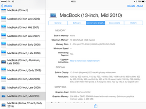

Maxi un 16gb 8+8
204-pin PC3-8500 (1066MHz) DDR3 SO-DIMM
what app is that?
