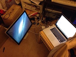

I’ve the same problem that OP describes but in my case the screen is black but with some black glow and no trace of any picture when you look closely — what the ACD Technician Guide describes as “no video” rather than “no backlight”. The opposite of most the answers here.
The computer is aware of the monitor and the sound, camera, USB all works — I can even control the brightness of what I assume is the backlight. But the screen is black, usually. But every so often the screen decides it will work and it works perfectly until it goes to sleep or I turn it off. That’s the thing I find weird.
The Guide says to replace the LCD panel.
But I’m dubious, as it feels like a logic problem. A broken LCD panel wouldn’t work occasionally, would it? It feels like a logic board, or maybe PSU, or maybe the octopus cable.
I was hoping the troubleshooting in this thread (by far the best I’ve found on the net) would shed some light on this case but it seems almost everyone was having backlight woes which they solved. Yeah good for you. (Actually the little wire trick sounded so cool I wished it was my backlight.)
I don’t have a second monitor to try swapping out components and figure there must be a better way than buying possible spares. At that point the suggestion to justbuyareplacment.com looks cheaper.
So how else can I tell what’s knackered?
Any armchair detectives? Some more clues below.
I’ve taken it apart and none of the capacitors look bulgy, no loose wires, nothing at all looks suspicious. Not even much dust in there, which is impressive as this is a dusty house and mostly for its 10 years of life it’s been sitting around unused.
There’s not much pattern as to when it works and when it doesn’t. Either it or the computer needs to be off for a while (30 minutes?) for it to stand a chance of working. It feels like unplugging everything for a while gives it a better chance of working, although sometimes it happily works without unplugging, as long as the computer has been off or in standby. The house is always cold, 17C, and the monitor never seems warm so I don’t think it’s temperature.
What I can’t help feeling is relevant is that the black screen first stopped working shortly after I started using it with a non-Mac and a Mini-Displayport to Displayport cable. Maybe I should have mentioned the infidelity sooner but I’ve not seen anyone anywhere talk about this being a factor. I blamed the motherboard in that new computer and the wire and all sorts but ruled them out (a) because even there it works sometimes, (b) I got a couple more cables and had the same problem, and (c) the problem persisted when I plugged it back in to the Macbook even after a {P,NV}RAM reset.
Now it doesn’t matter whether its the Macbook or the non-Mac, once in a while it works, but usually there’s just a black glow. Maybe it works a little more often if plugged in to the Macbook, like 1 in 10 vs 1 in 20 for the non-Mac.
The other breadcrumb for the detectives is that occasionally it comes up at boot with part of the screen showing, like 1/3 across the top, with the rest glowing black.
So could it be a fault in the Displayport wire, sometimes it lines up right and other times it doesn’t and once in a while one specific wire lines up so part of the screen works? I’m not an EE but that seems dubious. A vigorous shake of the wire doesn’t break it when it’s working, and that seems fairly conclusive to me.

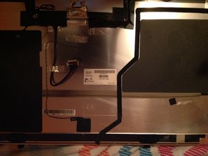

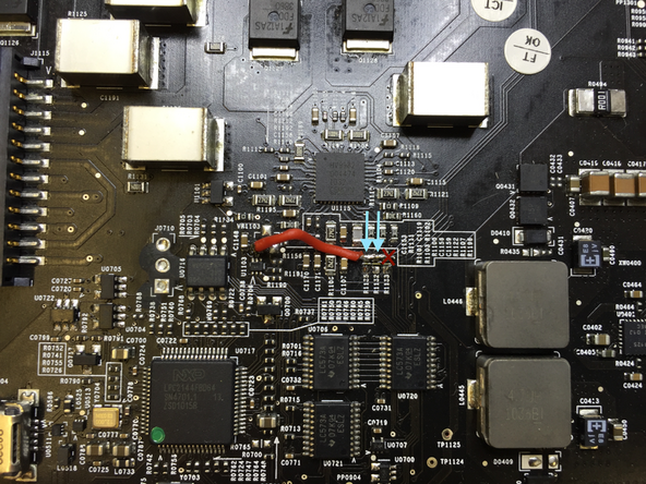

introduction
Before you choose this solution, keep in mind, there are many problems that cause no backlight. For example the mosfet, coil and diode components may be broken. In this case the driver detects a failure (with the feedback resistor) and turns off. In my case everything was right. The microcontroller doesn't provide the PWM signal. But it took a long time to get this information. First I measured the signals on the board. Is the driver enabled? What is the input value of the PWM (S1 and S2) pin. I also checked (with the help of the data sheet) the mosfets, coils and diodes: Which pin of the driver is connected to the gate of what mosfet and what kind of function does it have? In the end I found out, that the external components are ok, so I began to make some tests with the driver!
In the image

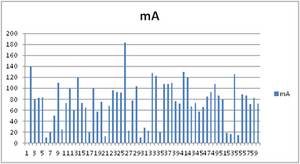

100% pwm signal
you can see the little wire that put the 3.3 voltage as input for the pwm signal. The backlight turns on and the cinema display is alive again!
the long story

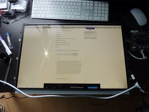

After four years of using the backlight of the LED Cinema Display 27" was turned off. First the backlight was very low or was flickering while trying to dim the display via the system panel. I turned the display off and on and then it was dark.
With the help of a torch light I saw a faint image of the desktop. USB and magsafe were working as well. So the display is working without the backlight.

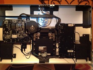

First of all I teardowned the display like it shown in Teardown Apple Display
The interesting parts are
  • the led driver HV9982
  • the mosfets and coils of the driver (producing 80 voltage for the led stripes)
  • the microcontroller

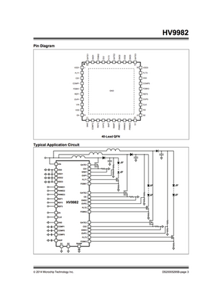

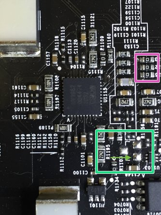

The led driver (called HV9982) is responsible to drive the leds stripes with current. It cares about the right current, because LEDs require more precise current management. The data sheet of the HV9982 you can find some basic information about the driver and this function:
HV9982 is a three-channel, closed loop, peak-current mode PWM controller designed to drive a constant out- put current. It can be used for driving either RGB LEDs or multiple channels of white LEDs.

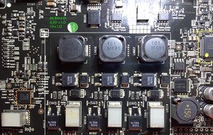

identifying the components
In the next image you can see the led driver with its external components:
the led driver
  • the mosfet, coils and feedback resistors (orange)
  • the connector for the led stripes (green)
  • the led driver chip (blue)
Using the datasheet of the led driver we get some interesting facts about the pins:
the pins of the led driver

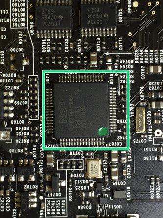

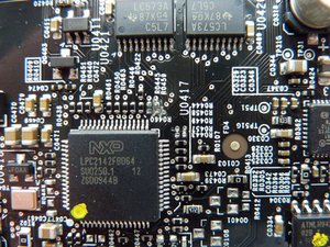

The led driver is controlled by the microntroller in the next picture:
the microcontoller

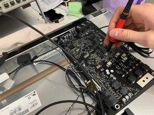

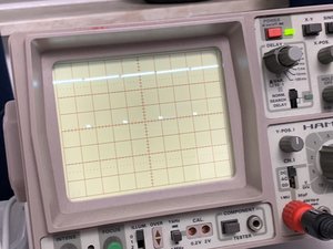

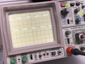

The controller turns the led driver on if the computer is connected via thunderbolt cable. With a multimeter you can measure a 3.3 volt signal on pin 10 (enabled). If the computer is unplugged then the signal is bound to ground. But be aware the is only litte space between the pins! Keep an eye on it to avoid short circuits! (To be honest, I did three short circuits, one hurts a bit and one does a nice spark.)

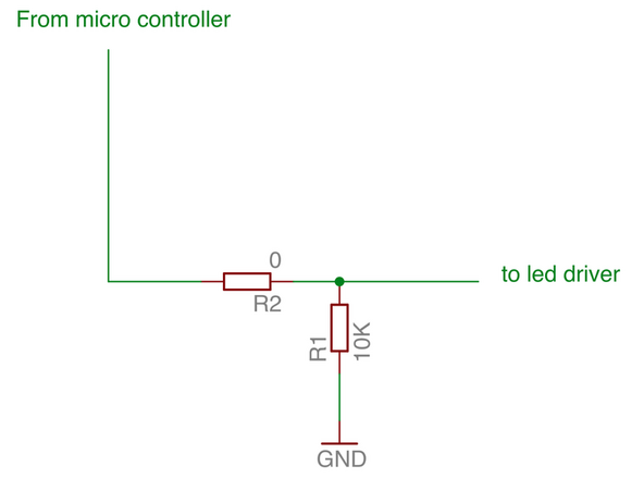

identifying the connections

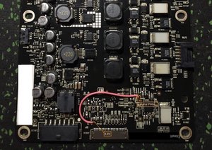

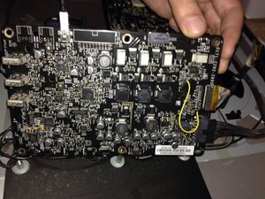

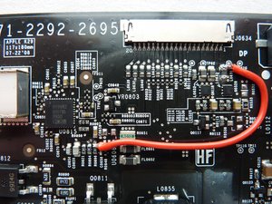

With the multimeter you can track the connections from pin to pin. I found out that the microntroller is connected to the pin 10 (enabled) and the pwm pins (17,18,19). The S1 and S2 pin are bound to ground and that means that the led driver is driven in the PWM mode. With the help of an oscilloscope I found out that the microcontroller does not send a PWM signal. He turns the led driver on but "forget" the create the PWM signal. In this case the backlight stays dark without any light. And you think the display is broken. (see for PWM)

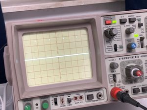

But we have some luck! We can bridge the signal to 100%. We just connect the PWM pins to logical one and that is 3.3 volt. I found a pad that give me the 3.3 voltage and the pwm pins from the microcontoller are bridget by three 0 ohm resistor (labeled with R1132, R1133 and R1135). You cannot just put 3.3 volt to the pwm pins because they are connected with the microcontroller. This would cause a short circuit. In the following image you can see how the microntroller is connected to the pwm pins of the led driver:
the connection the the pwm pins
The "R1" is a pull down resistor which is used the put a logical 0 to the pwm pins if the microncontroller does nothing. Now we make the following connection:
the modified schema with constant 100% PWM
The led driver is a three channel pwm controller and the board contains all components for three channels and the connector is prepared for three channel but channel three is not used! So don't put 3.3 ohn R1133! In this case the led driver detects an error and switch off. The led cinema display has only two led stripes! Therefore connect only R1135 and R1132 with 3.3 volt.
So what do you think now? The problem is not a hardware problem, it is a software problem. The software within the microcontroller won't create the pwm signal. Unfortunately we don't have the source code, so we are not able to patch the firmware. We just cut the connections from the microcontroller and send now a pwm signal about 100%. You aren't able to dim any more and you needn't buy a new one! Is this a software error or just a hint that you should buy a new display?
the 3.3 volt pad and the 0 ohm resistors
Good luck! Please keep in mind:
  • Avoid short circuit! The spaces between the components are very small!
  • The led driver creates up to 80 voltage!! That hurt's!
  • The board has 24 voltage!
  • You need two solder irons to unsolder the resistors.

PS: It was the **third display** where the backlight turns out. Unfortunately I didn't check them and they are trashed, because the local apple dealer said, that repairing is too expensive than buying a new one!
full backlight again

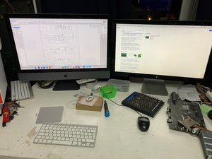

Well done !!!!! , you did all that without a boardview and schematic? Are you positive the driver is not a QFN?
Having repaired several hundred of these units and advising as to source, I would say that the implication that a software bug or intentionally timed failure is ludicrous. The processor does vary the signal but as a protective measure as I have described numerous times before. The case of an momentary flicker and viewable unlit panel operation is not solved by a replacement board because the problem is not on the logic board. A new logic board is relatively inexpensive and the monitors were worth it to a point recently but wouldn't help this problem. The same can not be said for the power supply. So much misinformation on these monitors that real information gets buried. A fix for the power supply under load problem would be your "next" step. Of course, repairing the board you have now altered will be an interesting challenge of your soldering skills.
Hi John,
yes, I do it without any schematic. Just checked some connections with a multimeter and the data sheet of the driver. The driver is a QFN chip but you can touch the solder pads and that is some what thrilling because you can very easily connect to pins. For example: the enabled pin is next to VDD and VIN.

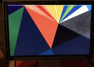

Update (28.02.2016)
my Cinema Display 24" FIX :)
Step 1: Remove the 3 resistors R0444,R0459,R0445
Step 2: connect the 3 pull-down resistors to 3.3V (
ONLY the page to the driver IC)
END FIX
Have fun and viel Spaß ^^
-->!!WARNUNG /Warning !!<--
the L-board has 24& 70 voltage
**Nachbau auf eigene Gefahr,ich übernehme keine Haftung**

Hi Guys,
I got an defective Apple Cinema Display for 150 bucks. There is a Picture but no backlight. I followed Michaels solution, many thanks for that btw.
I removed the two jumper resistors going to the led driver pwm inputs and shorted them to 3V. still no backlight. Well sure! The MCU is sending 3V to the third led driver connection - thus the led driver switches off as it thinks there is an error.
So i started from scratch to identify every of these three connections between the MCU and led driver. It turns out that R1133 and R1132 are the pwm signals for the led strips and R1135 is the “error/shutdown“ signal for the led driver!?
With power connected i took my measureing probes and carefully supplyed 3V to the pwm input of the led driver. both led strips where controllable this way - so the led driver is working.
(last picture shows the display with the old backlight leds - thus the color is a bit wrong -> yellow-/redish)
As shown in the pictures you can see the pwm signal in 3 states - LEDs off - 50% On - 100% On.
(controlled with my imac connected to the ACD)
So the MCU is also working BUT is sending 3V to the third connection… i gues that the mcu is doing the current sensing and is shutting down the led driver in case of overcurrent!?
So why is that…
According to Apple, the LG Panel in the ACD is given with a lifespan of 36000 hours. Its nearly 7-8 years old.. so most likely the panel is way longer in operation than 36000 hours. Especially because i noticed, that the display is half as bright as the same LG Panel in my iMac (with the transitional fix given below)
Long story short: I ordered new backlight leds from aliexpress for about 10 bucks, replaced the old ones and now the display is as bright as my imac and working reliably.
So no software/mcu issue at all (for me at least).
For the dirty fix you can just remove R1135.. thus disabling the current sensing. One safety option less but full functionality. I did so to overcome the time until delivery of the new strips.
Link to the LG-panel LM270WQ1 led strips: https://de.aliexpress.com/item/328453350...
i apologize for any spelling mistakes.. greetings from germany.

  1. here are some pictures of the Cinema Display
  1. Here's the back of the logic board
I had the same problems. Backlight was gone or very low.
The short story: I found out that the micro controller does not send the PWM signal to the LED driver.
Very mysterious! I checked the LED driver components (Mosfett, diode), I read the data sheet to understand the function of the HV9982 (LED driver). In the end there was no hardware problem there. If I connected the computer the micro controller enabled the LED driver but "forget" so send the PWM signal, so the LEDs stayed off.
Mmmm...maybe this is a software error or Apple wants to tell me to buy a new one? So I bridged the PWM input pins with a little wire connected to a 3.3 V pad (which I found about 1 cm around). Nice that die PWM output pins of the micro controller were bridged by 0 ohm resistors, so I could remove same and cut the connection from the micro controller. And then I got full backlight again. Of course I am not able to dim the backlight anymore.

I don't mean to offend anyone but you all seem to have missed the blatantly obvious and that is the LED backlight array.
LEDs age, and as such the amount of light that is emitted reduces. The LEDS in the LM240WU6 panel are made by Lumileds which is a subsidiary of Philips who in turn produced the panel under license from LG. The LEDs used are LXML-PWN1-0120 which should be operated at a forward voltage of between 3.0V & 3.6V @ 350mA and have a stated 39000 hours of life.
LEDs operate in constant current mode that is the current through the device is adjusted by altering the voltage across it. In low current LED applications this done with a simple resister. In high powered applications this is done with a controller chip such as the HV9982. Most high powered applications work as a closed loop system, that is they monitor the current flowing in the LED string and adjust the voltage across the string accordingly. The circuit Apple adopted does just that, it monitors the voltage developed across a low ohm resister in the bottom of the LED string and adjust the PWM signal to the HV9982 that will adjust the voltage to the LEDs. The suggested fix above of applying 3.3V to the PWM input will remove this feedback and will apply maximum voltage across the LEDs and is likely to result in damage to the LEDs and driver circuit.
What most people are experiencing is the backlight driver circuit shutting down due to it reaching an overvoltage point as it tries to pump more current through the aged LEDs.
The above plot shows the current through each LED with a forward voltage of 3.3V. As you can see there is a lot of variation (LED 1 shows as 0mA), none of them get near the 350mA that they should.
Conclusion, the only long term way to fix this problem is to replace the LED string as a whole or at least the weaker LEDs. The individual LEDs are available from DigiKey but they will prove difficult to replace as they are surface mount and are tied to a heat sink back plate. An alternative is to retrofit a low voltage backlight replacement string, they are available on eBay for as low as £4. These will require a 12V supply and will need to be turned on and off manually.

Have already forgotten about my 2009 ACD 24", it was standing around and getting dusty for 3 years now since it gets dark screen - thought thats it, no more spendign money, no time and no idea how to fix it ... In the last days I decide to give it a try after reading all yours comments and promising results. thanks for that!
When I bridged the resistors together R0821, R0804, R0896 and 3.3V it starts flashing like some described before... So I remembered this fault behaviour is shown by LED elsewhere when flashing is caused by overheating. While I disassemble the LG LCD unit, I was astonished about some sort of soot on the screen inside, maybe because of the mirror foil was getting crusty, baked all around the thin aluminium rail with LED on it...
Finally I decided to connect the 3.3V to the resistors separately. R0821 and R0804 are still flashing, but it works well for R0896! In conclusion only one of the 3x20 strings on the LED-rail will work, thats not that bright but sufficient and great for night shift.

Hi the led driver you are referring to is it the small board that is attached to the LG screen where the function cable, heat sensor etc is connected to?

so i got yesterday a 24 inch cinema monitor for free (someone was close to put it in the trash….) where backlight sometime worked and sometime not.so i tryed the fix from willi and monitor flickered. so i jumped only R0804 and R0896 to the 3.3V rail and voila the monitor works again :)
The problem on this 24 Cinema (and also on 27 Cinema and 27 Thunderbolt) is NOT the board but LED stripes. The rail mod is temporary solution. You have to change LED Stripes (2 led stripes on 27 inchs, they are the same used in iMacs 2011 panels) or single 24 inch led stripe.
It's possible to reflow the LED stripes, this work usually is more durable.
Soon I'll publish some article about this work.

I have been reading these threads the last few days as bought one as broken for 20 quid. I found repeatedly inserting the minidisplay connector and then plugging in the usb kept the screen working for as long as the usb was connected, even if you unplugged and replugged in the disply port however......
I took the monitor apart completely. disconnected all cables and wires removed logic board, power supply and sub woofer and gave everything a really deep clean. Blowing out and toothbrush removing an enormous amount of dust from the fan. Reassembled checking all cable/wire connectors were well seated.
First time reusing took several attempts at plugging in mini display to get it to work, but then.... next time i plugged it in works straight away and at FULL BRIGHTNESS. MUCH better than before!!! I have now unplugged and replugged in mini display 20 or 30 times and it connects every time first time WITHOUT usb connected!! I have also tried every combination, unplugging monitor power while connected to mini display on macbook? Fine. Unplugging mac, then unplugging monitor from power. Turning power back on then connecting to mac? Also fine. Every variation of connection and disconnection. I would thoroughly recommend just giving the unit a thorough clean and checking ALL connections to logic board, power supply, speakers, display, and the two heat sensors. Maybe this won't last long, but maybe it will!
