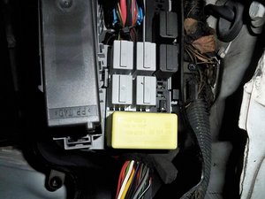

My right hand indicators don't work properly and I have been told that it is probably the relay. And wouldn't you know it, apparently it's a real pain to replace? Because of its location. Apparently it is behind the battery and something else. Any help please.

Geoff Heyes, the relay is located under the hood, adjacent to the battery. You should see a black weather sealed box. You will need a long extension and a Torx ( I read a T20) socket to remove the cover. The indicator relay is the large yellow one.

This relay is located near the BCM module. It is located under the plastic that covers wiper linkage and motor. There is another plastic that covers BCM module and relays near it.
