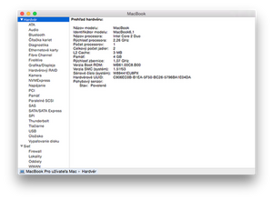

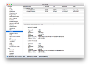

I'm currently on this model right now typing with the less released version and can verify that I have it running at 1333 for the RAM. Yes, it even shows that.
It's kind of a moot point though because the bus speed is only at 1066 so the RAM will slow down to 1066 even if it doesn't show it.
There are people out there that will say you can hurt the system by running faster RAM; however, I don't believe that.
Just understand, and you can trust me on this, there will be no performance difference between the 1066 and the 1333 due to the bus speed only being 1066.
So why am I running the 1333 if there's no performance difference? Only due to the fact that this is MacBook I'm selling and have it torn apart currently.

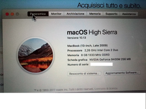

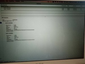

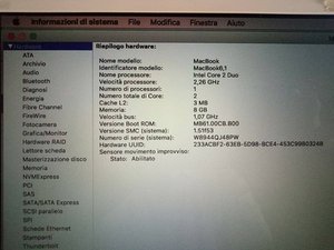

I confirm that the ram (Corsair CMSO8GX3M2A1333C9) on macbook late 2009 MacBook6,1 MC207LL / A system that has the 2.26 GHz P7550 and the MB61.00C8.B00 boot ROM today with 2x4GB 1333MHz works perfectly sees the 8GB and runs at 1333MHz . Good upgrade to all of you.
Update (10/07/2017)
These are the photos as a demonstration for those who might have doubts about when done.

Ciao a tutti,
quindi confermate che acquistando le RAM (Corsair CMSO8GX3M2A1333C9) con un boot rom MB61.00CC.B00 e versione SMC 1.51f53 il MacBook vede gli 8Gb di RAM senza alcun aggiornamento di firmware?
Grazie
si confermo ho messo le foto per questo ormai da anni nessun problema.
