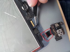

I run a small repair shop, and im encountering this problem. This issue has been constant on several iPad Minis we had tried to replace the touchscreen.
Even we support ourselves on different repair shops when something is acting fishy. And they also some times rely on us when an issue they can solve.
The issue is that after replacing the touchscreen, the iPad mini will become unresponsive and will boot on the Apple Logo Screen, then the Screen will dim and become unresponsive.
We had tried a variety of touchscreens and with different suppliers. And issue persists.
We had been soldering the iPad mini touch board to the new Touchscreens, but with no luck. Only the home button works.
Has anyone else encountered this problem and know how to solve it?

definitely the bottom section of cheap digitisers not being taped off correctly next to home button. Lie the new and original digitisers next to each other. To test if this is your fault lift the digitiser very slightly away from the screen from home button end (be careful not to lift too far due to the ribbon cables underneath) and try the home button lock button screen fade etc. worked for me. Switch 2 x tape pieces (one square shaped and one rectangular ) and don't forget clear spacer tape under square section. hope this helps

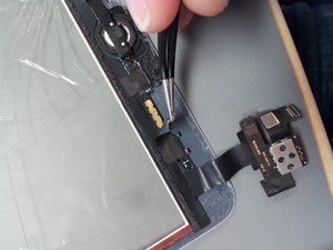

The problem lies with the circuits to the left of the home button. Cover all surface mounted chips and gold areas in kapton take. This will almost 100% solve the problem.
Thank you so much. It work perfect after covering up the section showed in the picture.
WOW, worked perfectly! I placed the kapton tape on the digitizer on both sides of the home button.

cover the bottom with type if you look at the 1 you took off from factory every thing is covered
The little ribbon in the back must be covered. See picture. Remove the extra foam tape at the bottom. Also, the darkening is usually caused by a bad IC chip. You will need a factory one, or you can buy a new one, which means you want to buy quality. Not something cheap because cheap IC chips will do that. Check the soldering job twice. That could be the problem. Clean everything, including the connectors.

As for the iPad mini jumping around after a digitizer replacement, thank you to those who suggested covering the bottom of the digitizer with tape. Be sure to put it all across the bottom. Worked like a charm! Wish I would have read these posts 3 hours ago!!!!
what is the digitizer?
selotape across the bottom edge of the digitizer not just the home button cable works a treet.

My issue was whenever I pressed anywhere on the bottom of the digitzer siri would be activated or I would be sent to the login keypad. I taped all exposed gold to the left of the home button and it worked. I used electrical tape which may not be the best but seems to be working.
