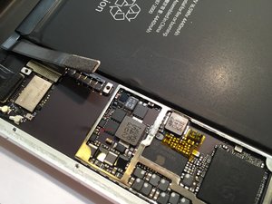

Th screen stays black after a digitizer replacement.
I successfully replaced the digitizer of a customer's iPad Mini with the soldering method.
I connected everything and tested, and it was successful except for the home button. I disconnected the digitizer flex and the screen flex and the battery also. I wanted to test again and connected everything. I tried to turn on the Mini, but only had sound and no screen. The screen stays black.
iTunes recognises the Ipad Mini, and I did a DFU in hopes that it would work, but no success. NO SCREEN.
What can I do? iTunes says the battery is 100% charged.

Do you see picture just no backlight?
If I push the powerbutton, the Apple logo apears, but no backlite. Just seen this with the screen turned up into the sun.
I need a clear picture of the fuse that must be jumped, or how to use the Bare Conductive Pen to create a jump across the fuse to "what?".
Replaced touch screen. Now have no picture. What fuse do in have to bypass. Can you post a picture or video. Thanks for the help

Make the jumper or replace the fuse.

YoloRepair ca ,,,so if I'm seeing your pic correctly I would need to jump the 3 points outlined in green ????
I cannot stress this enough. Restart the ipad by holding the power button and home button OR unplug and replug the battery.
If that fails
If you look at the pic I posted the green line is the path the line takes.
The red line is the fuse (you're essentially bypassing it - you could replace it) if its blown replace or bypass.
Having a multimeter is crucial for this type of work. Otherwise you could damage the ipad further. Plus it will help you determine what is at fault (most times it's the fuse)
Strong soldering skills are a must.
crwdns2934275:020crwdne2934275:0
Wow.... Ok let me sum this up so no more people are confused by this pic. The path of the electricity to operate the back light follows the green line from the top right of the pic thru the fuse marked in red to the connector. To bypass the fuse all you have to do is lay a bead of solder on top of the fuse that connects the left and right side of the fuse pad. You do not need jumper wires or anything else. If you want the correct fix, replace it. But this works as I have done it before. You can test the fuse for an open first with a multimeter to make sure this is the issue you are having. Put the meter on the continuity setting, touch the right side of the fuse with one lead and the left side of the fuse with the other lead. If you have no continuity then lay solder across the top of the fuse, making a bridge for the electricity to flow past it. If you have continuity (usually .02-.03 ohms) your problems is somewhere else in the circuit.
To add to this: the fuse is there for protection just like any fuse is in any electrical circuit. It you successfully bypass it with the solder method, make sure you don't make the same mistake again as you may end up with irreparable board damage. What causes this problem to happen in the first place? Good question. It's caused by disconnecting the screen while the iPad powered or possibly turning on the iPad on accident while the screen is unplugged. Easy solution is to have to make sure that you disconnect the battery before disconnecting the LCD connector and reconnecting the battery after the LCD has been reconnected to the board during reassembly.

Here is a close up of the iPad mini backlight fuse---ideally you would replace it for a robust long lasting solution which is very straightforward to do with the right equipment and experience. If you insist on jumping it, you would need to lay a bead of solder across the top of this component with the red arrow.
Keep in mind--this picture is an image that I took to send to a customer that came to me from this very thread that knocked off the two essential components circled in red while digging around trying to make the jumper. The capacitor just to the right of the backlight fuse is only found on the iPad mini and the iPad 4 and is difficult to source if you damage it and have to replace it. The capacitor on the left is essential and required. The two small components that are missing in this picture are also essential and must be replaced, not jumped, if they are damaged. These "DIY rescue" repairs can quickly get very expensive so BE CAREFUL!!

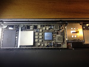

I've decided to post some DIY fails here. This is such a straightforward, inexpensive fix to send out for...it always makes me sad when I get these trainwreck minis sent to me. Repair is noble when you use the right tools.
DIY Fail---This is exactly why NOT to jump the fuse. This guy burned up his diode with this way too big wire.
This is a great way to short out your iPad, except it was already done. If your jumper has continuity with ground (like this one) you're done.

I have three iPad mini's now from folks from this very thread that have tried to jump the backlight fuse and then ended up knocking off tiny components around that area. One of them didn't even realize that he'd knocked off a resistor and capacitor in front of the fuse just by probing it. Another knocked off four small resistors at the power button side of the board under some tape just from trying to remove the shield. Another thought he could just jump a nearby tiny resistor that fell off and shorted the LCD voltage to ground!
Sourcing and replacing these missing components can be a HUGE drag--especially if the solder pads are torn and a line must be traced to the previous component in that trace. Ugh! Tedious hours of work.
It is *so* easy to do the repair correctly and replace the fuse with the right tools. I use a Hakko FM 2023 mini hot tweezer and a microscope to desolder some of the shield, and then pinch the tiny fuse, pop it off. Pinch the new fuse, pop it on. Done.

Jumping the backlight filter is a bad idea guys--that will likely cause you (or your customer's) backlight coil to fail prematurely. This is especially true if you are putting a mini back together and testing your digitizer soldering job, home button etc and keep plugging/unplugging the LCD. The filter is an easy part to replace--about $5 on eBay. In fact, replacing the whole backlight coil, filter, and ic is less than $20 for parts cost and takes just a few minutes with a hot air station and a little experience. The mini does seem particularly sensitive to the sudden change in voltage that comes from unplugging the LCD. I've learned this the hard way!

your backlight is still out because the backlight diode, commonly called backlight ic, is damaged. The backlight diode is very sensitive and easy to damage. If you replace the backlight diode, you will likely bring back your backlight---and at the same time you might as well properly replace the fuse with a new one. If you don't want to send your board out to have it done professionally, and you want to try to replace the backlight diode DIY, just remember that the diode is a directional component--you'll need to place the new one in the same orientation as the original with the side with the lines facing the home button side of the iPad.

You got no pads here any more. This mini can be saved, but it will have to get the "long jumper" solution to link directly from the backlight diode to the LCD connector area. Almost always, the backlight diode is burned out when the mini looks like this. This is an advanced rework project now.

Hello, jessa, have a problem. Did a repair on a mini. Powered off, replaced digitizer and soldiered on old IC chip and home button. Before sealing everything up, I turned it on to test everything...a section of the LCD wasn't displaying anything and digitizer was 75% functional. Powered off and disconnected LCD and digitizer to recheck soldiering points. Reassembled and now won't turn on. No apple logo. No sound when plugging it into wall socket or computer for iTunes. ITunes does recognize the mini though being connected and password protected.
Gary--sounds like classic backlight. If the LCD has a black stripe/lines then it will need to be replaced as well.
Jesse, thanks for the reply. Why does this sound like "classic backlight"? If it was just backlight issue, wouldn't the iPad at least be dimly lit and have sound? I'm getting nothing... like it doesn't even power on.
Could this have something to do with the "lock" feature associated with the home button flex cable?
**Update on my first post... it appears when I plug it into wall charger, there is that "plugin" ding sound.**
The dim logo/chimes are not a reliable indicator of a backlight failure. It sounds like classic backlight to me because we know the iPad is powered on since it is recognized by iTunes. It now has no display after a recent disconnect when shortly before it had a display, even if the LCD was damaged. This is either that the LCD itself is now completely damaged (less likely) or that you have burned the backlight filter at this disconnect (classic). I would bet that under the microscope you'll see the physical damage to the backlight filter evident as a tiny pin !$$&* of solder bulging from the center of the filter, or it will look completely burned.
It is very unlikely that you damaged anything on the board relevant to backlight from your work with the touch ic and home flex. You may not have touch, but even a botched touch ic solder job will still show the apple logo. Post a clear close up of your backlight filter--bet it is burned.

Thanks Jessa and all the others that responded. Considering it powered on fine after the repair, I wanted to wait 24hr in hopes that, like a few of the others, a few hours would correct the issue. It did not, so I went ahead and messed with the filter. I wanted to lay a line of solder from one end of the filter to the other, but as you know, it's delicate work and I've never done a soldering process that intricate. I have a soldering gun with a pencil tip about .6 millimeter at the pointed end. I cut TINY pieces of solder off a line and tried it like that first. Didn't lay right so I pulled it off and took a small section of one end of the filter off. Lol. "From bad to worse", right?
Not so. I assessed the situation and tried again. This time I cut more TINIER pieces and dabbed one tiny drop at a time and arched from one end of the part I kinda jacked up, to the other end of the filter. Results? I have a working iPad mini now! Of course, the LCD was still jacked, so will have to buy a brand new part for my brother-in-law. Lol, as long as I got it working though. Kudos to you, Jessa, your advice was much appreciated. To the others, as well. Happy holidays.

This is still going to backlight filter is my guess. It is just Soooooo common. Replace the filter, possibly also the diode and it will probably solve. If you see no damage to the filter and it has continuity, then second choice is that it is the LCD itself. Third choice is damage to the digitizer fpc connector --digitizer is required for display past the apple logo in the mini
Thanks for your recommendation. It was the fuse. Somehow, my fuse did not blow out totally, and it is read 95 Ohms on the multi-meter. I bypassed the fuse and the backlight came back, and the mini Ipad is now alive. Thanks again.

I've done this repair on a couple of minis, but now I've got a mini 3 (a1599) with the same problem. Anyone know exactly where the fuse on this is? I can post a picture if needed.

This is the A1490 32gb board does anyone know ware the fuse is located?
Guys, before any dangerous or irreversible operation, remember to try to remove ONLY the battery for few minutes!
In my case it worked, I think there is some integrated protection to protect the fuse.
I have bridge the fuse on many iPad mini 1 (over 30) without any problem, don't know why this fuse blow, not always but often and i always disconnect the battery first... ***But never do a fuse bridge on IPad mini 2/3/4 the diode will burn in 2 seconds, i know because i have try once... well at least its easy enough to replace with solder paste and the fuse, the diode, the coil are less than $0.75 each if you got some good suppliers, on eBay they are a way too expensive !!
