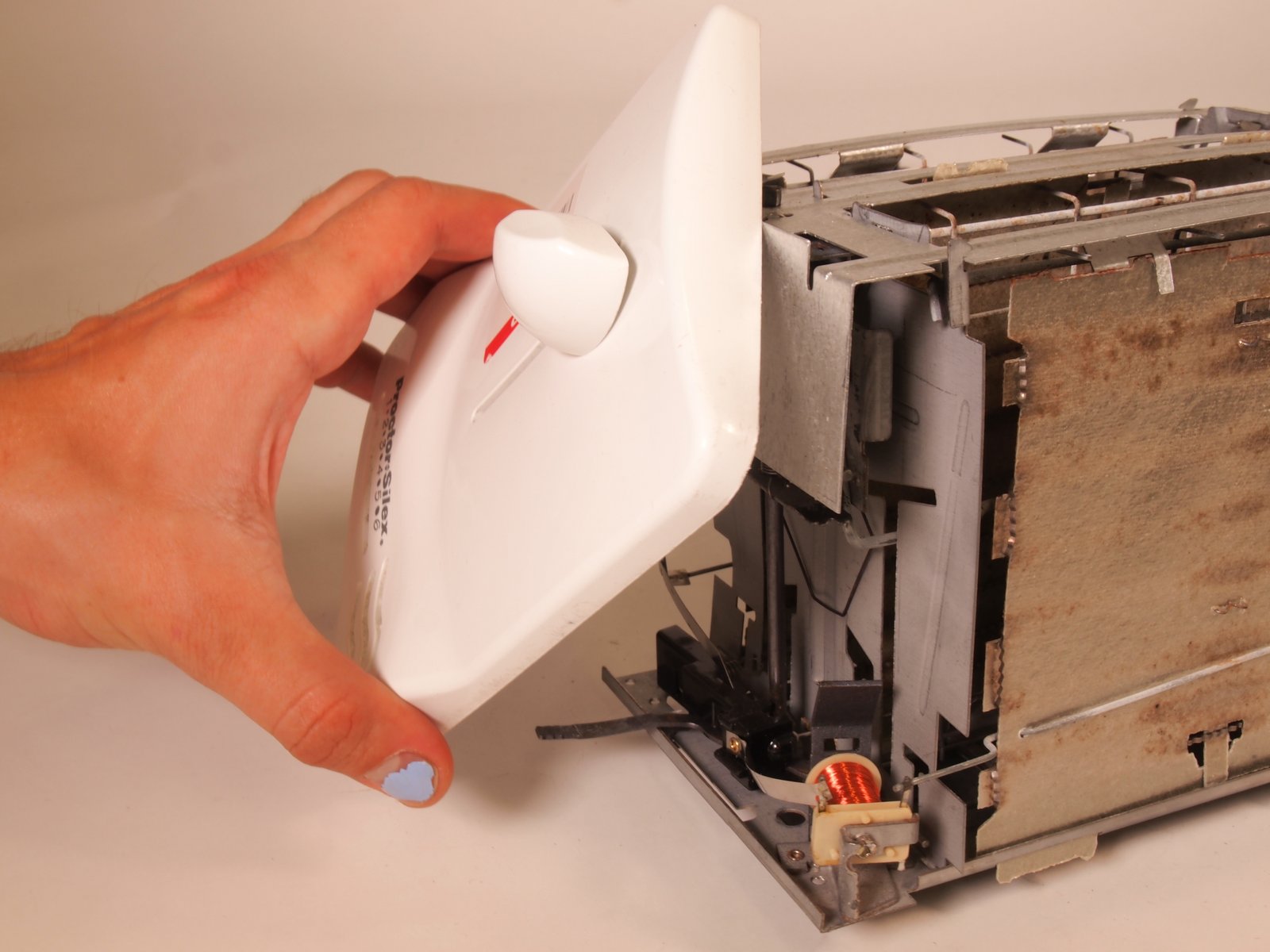

Some toasters are easier to clean than others. You'll be able to do a much more thorough job if you disassemble the toaster and clean the internals completely. This will also give you a view of the latch mechanism.
Crumbs Blocking Magnet
The toaster mechanism stays down when the level triggers electric flow and enables a magnet at the bottom of the toaster, just below the down level. The magnet holds down a metal tab, located at the bottom of the level mechanism until the selected temperature is reached and electricity ceases. When the electric flow is disrupted the magnet is de-magnitized and the toast comes up.
Sometimes a crumb can be stuck between the magnet and the bottom of the level where the tab is located. It is not difficult to take apart and examine the mechanism.
Disassemble the toaster to reach the magnet. Every toaster is different, but here is a general guide and our toaster repair section has a wide variety of specific instructions for toaster models.
Once you have access to the magnet, thoroughly clean the space between the magnet and the slider. Compressed air works well for this. Use a cotton swab with alcohol. If you use water to clean the toaster, wait for it to completely dry before you power it back on.
