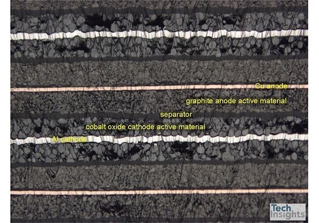

Modern smartphones use lithium-ion (Li-ion) batteries. These contain layers of a metal oxide around a metal cathode and graphite around a metal anode. Thin sheets of electrolyte-soaked polymer separate the anode and cathode layers.
Image via EEPower.
Image via EEPower.
Lithium ions, initially part of the metal oxide, shuttle between the anodes and cathodes through the separator layers. These ions cause reactions in the anode and cathode layers that move electrons—resulting in the battery charging or discharging. Different batteries use different chemistries, but the basics are the same for all Li-ion cells.
