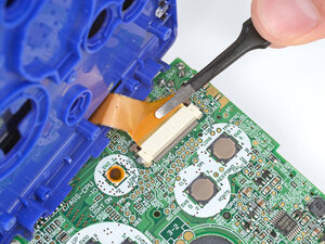

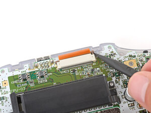

Spudger
A spudger is not only useful for delicate prying tasks, but also for poking and pushing connector locking tabs.
