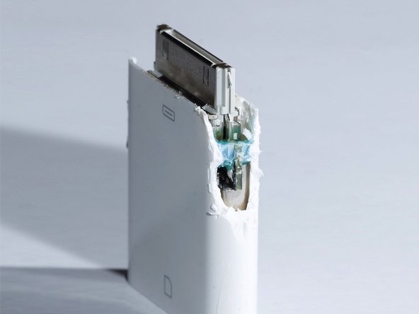

  3. iPad Camera Connection Kit - SD Card Adapter Teardown: crwdns2935265:03crwdnd2935265:01crwdnd2935265:01crwdne2935265:0
    • And here we see the reason for the plastic cover's reticence.
    • Apple has chosen to assemble the adapter with epoxy.
    • Effectively, there is no way to non-destructively disassemble the adapter.

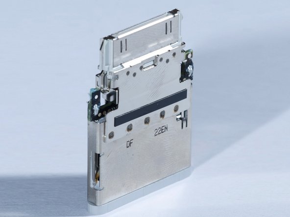

    • With the casing removed, we see... More barriers!
    • The Circuit board is protected by a metal EMI shield, which is liberally spot-welded in place.
    • This thing is utterly un-repairable. It seems it is designed in the same manner as the magic trackpad, and many of Apple's other recent pieces of small hardware.
  7. iPad Camera Connection Kit - SD Card Adapter Teardown: crwdns2935265:07crwdnd2935265:01crwdnd2935265:01crwdne2935265:0
    • Onward! Spot-welds are generally fairly brittle, and these welds are not very strong, since a truly penetrating weld would likely heat the metal to the point where the plastic parts would melt.
    • Therefore, by forcefully prying, the spot-welded metal components apart, it is possible to break the welds.

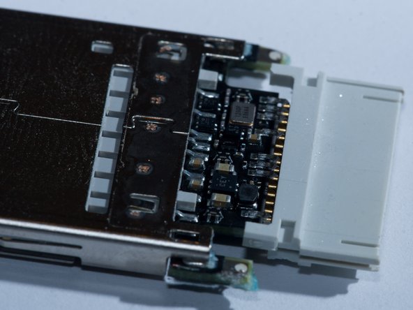

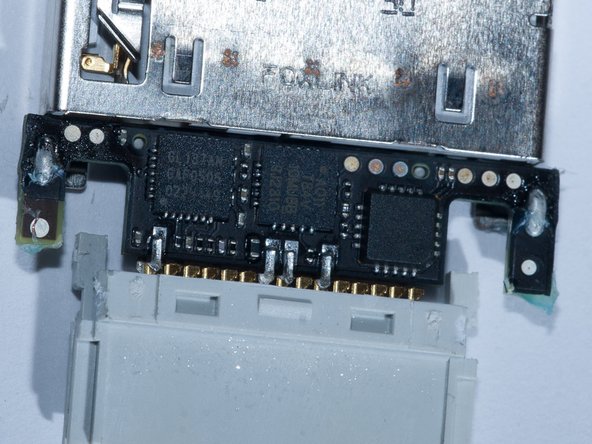

    • Finally, the circuit board revealed!
    • considering the size of the board, there is a lot of hardware packed on to it.
    • GL137AN GAF0505 022H149 - In a 28 pin QFN package
    • A011 T84V 10MUBB 9J2310 - In a 20 pin QFN package
    • 2257 AE072 90K - In a 20 pin QFN package of different origin.
    • Assorted 0402 and 0201 passive components.
    • Testpoints, complete with visible divots from probing during manufacture.
  9. iPad Camera Connection Kit - SD Card Adapter Teardown: crwdns2935265:09crwdnd2935265:01crwdnd2935265:02crwdne2935265:0 iPad Camera Connection Kit - SD Card Adapter Teardown: crwdns2935265:09crwdnd2935265:02crwdnd2935265:02crwdne2935265:0
    • Finally, the bottom of the interface board. Of interest, what appears to be a small DC-DC converter of unknown purpose. The iPad only supplies 3.3v. For the USB camera connection adapter, a DC-DC converter is required to provide the 5V to run USB devices. However, SD cards run natively on 3.3v, leaving the purpose of the DC-DC a mystery.
    • Tiny package marked only with patterned dots, likely for computer recognition.
    • Little tiny SMT inductor. Unmarked.
    • CEY and some dots. Location near inductor leads to it being likely it is the DC-DC converter IC. 6 Pin package.
    • 94F5LF - Very small package, Likely BGA.
    • ET ZD - 4 Pin Package.
    • 1200P E06AA - Almost certainly a canned clock oscillator. Probably some permutation of 12 MHz.
    • 3 Small 6 pin packages. Pin arrangement leads me to believe they are ferrites or some sort of filter. Probably part of power supply
