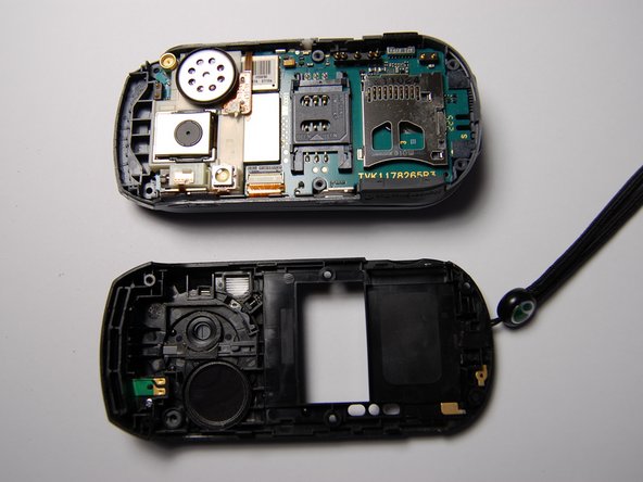

  7. Sony Ericsson s710a Teardown: crwdns2935265:07crwdnd2935265:01crwdnd2935265:01crwdne2935265:0
    • Once you have removed the back cover, use the plastic opening tool to carefully pry out the circuit board.
  8. Sony Ericsson s710a Teardown: crwdns2935265:08crwdnd2935265:01crwdnd2935265:01crwdne2935265:0
    • Remove the LCD cable connectors coming from through the hinge hole with a flathead screwdriver.
    • Be sure to record which port each cable was in, including the orientation in which they were plugged into each socket.
    • Now the two parts of the phone are separated.
