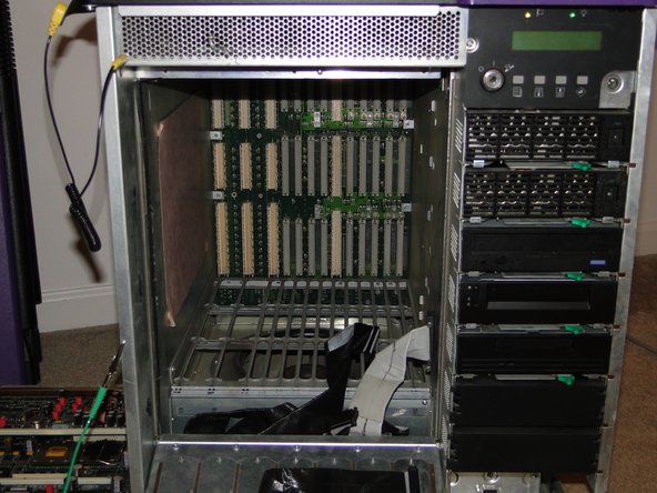

  4. SiliconGraphics Onyx Teardown: crwdns2935265:04crwdnd2935265:01crwdnd2935265:01crwdne2935265:0
    • The bowels of the computer are now revealed to us!
    • The card cage is 9U VME size, which means that each board is about 14 inches square.
    • Memory Board (MC3, 32x64MB (2GB)
    • Processor Board (IP25, 4x MIPS R10000 @195Mhz)
    • I/O Board (SGI IO4)
    • Geometry Engine (4x GE12 SGI-proprietary ASICs)
    • Raster Manager (20x "quad core" image engines- 80 total, 16MB)
    • Display Generator (Two Graphic terminal DACs and video I/O

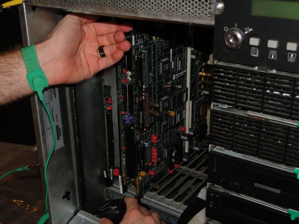

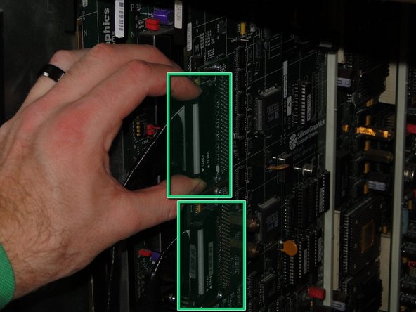

  6. SiliconGraphics Onyx Teardown: crwdns2935265:06crwdnd2935265:01crwdnd2935265:03crwdne2935265:0 SiliconGraphics Onyx Teardown: crwdns2935265:06crwdnd2935265:02crwdnd2935265:03crwdne2935265:0 SiliconGraphics Onyx Teardown: crwdns2935265:06crwdnd2935265:03crwdnd2935265:03crwdne2935265:0
    • Remove circuit boards by pulling the top and bottom lever out simultaneously to disconnect the backplane connection.
    • When the card is disconnected from the backplane, slide the board out of the cage and store it in a safe place.
    • The safest place to store a circuit board is inside the machine. If a board needs to be stored outside of the machine, place it in a shielded, conductive bag, and wrap it in bubble wrap.
    • It is easier to remove a board next to an empty slot. If a board is sandwiched, especially the memory board (first slot) or display generator board (last slot), remove the adjacent board first.
    • When all boards have been removed, admire the backplane and blower.

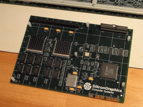

  11. SiliconGraphics Onyx Teardown: crwdns2935265:011crwdnd2935265:01crwdnd2935265:02crwdne2935265:0 SiliconGraphics Onyx Teardown: crwdns2935265:011crwdnd2935265:02crwdnd2935265:02crwdne2935265:0
    • The raster manager processes the image raster and also provides texturing capabilities.
    • the RM6 is available with 16 or 64MB texture memory, this is a 16MB version.
    • InfiniteReality can run with 1, 2, or 4 RM boards. Raster memory will increase in size with additional boards; texture memory increases in speed via interleaving.
    • 8 TM ASICs control 32 SDRAMs (on the back of the board) which make up the texture memory
    • 80 "image engines" are on 20 quad-core ASICs. These control the raster memory (framebuffer) as well as providing many image operations such as blending, dithering, etc. They can be thought of as a precursor to the "shaders" or "stream processors" on a modern day GPU
    • With a fully-realized modern InfiniteReality4 system (with 4 RM boards per pipe and 16 pipes in a system), the system can contain up to 16GB texture memory and 160GB of framebuffer!
    • This makes for very nice pictures even on IMAX-sized curved screens with many projectors blended together to form a single image.
    • Such a system will fill many computer racks. They are still in commercial use throughout the world.

  24. SiliconGraphics Onyx Teardown: crwdns2935265:024crwdnd2935265:01crwdnd2935265:03crwdne2935265:0 SiliconGraphics Onyx Teardown: crwdns2935265:024crwdnd2935265:02crwdnd2935265:03crwdne2935265:0 SiliconGraphics Onyx Teardown: crwdns2935265:024crwdnd2935265:03crwdnd2935265:03crwdne2935265:0
    • The system controller/ operator panel is held in place with one screw
    • Remove the screw and pull the panel out of it's tabs.
    • The system controller contains a keyswitch to start and stop the machine, a LCD display that shows a nifty CPU usage graph when running, and 4 operator buttons to control the system controller.
    • This console can display fan speed and temperature, power supply voltages, and logged error messages.
    • How many computers do you know of that start up with an ignition key? :)
