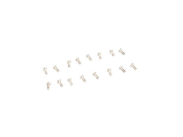

    • Remove the 16 screws all together on the middle housing. That is a lot of screws.
    My galaxy note 4 would not turn on. When it was opened up it had 15 screws and in the upper right hand corner there was a brass rivit. While trying to drill the display was broke.
    Have you ever heard of a rivit replacing a screw by Verizon or Samsung.
    The phone was a replacement under warranty.
    I mean, ... what the F xxxx !!!

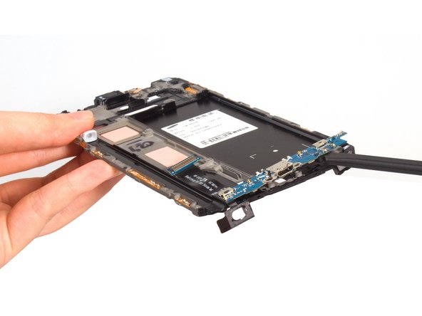

    • Separate front assembly from middle housing successfully.
    • The whole front assembly comes with motherboard, USB board, cameras, LCD screen and some other small components.
    • The back housing comes with power & volume button, headphone jack and loudspeaker. And except loudspeaker, other parts are easy to remove.

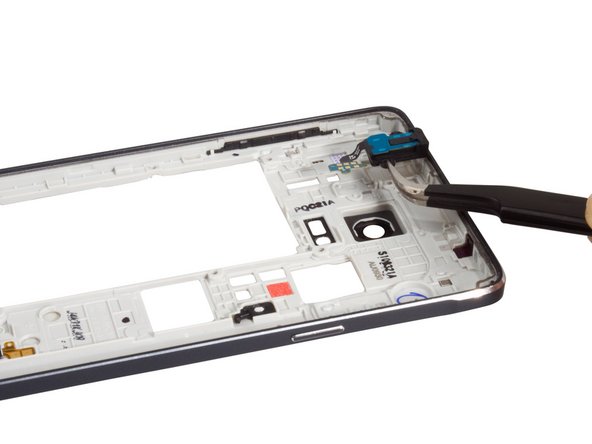

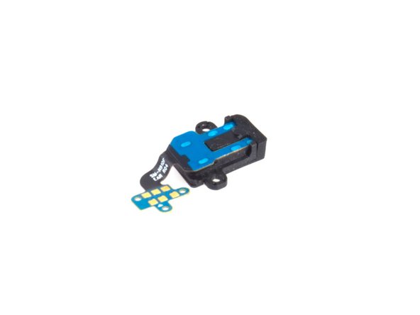

    • Get the flex free from the adhesive underneath and remove headphone jack naturally.

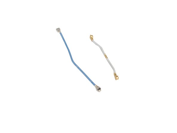

    • Remove 2 pcs of signal flexes. And maybe different versions Galaxy Note 4 comes with different numbers of signal flexes. Possibly one or two.

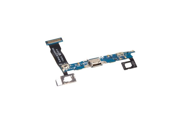

    • Pry up the USB charging board and remove it.
