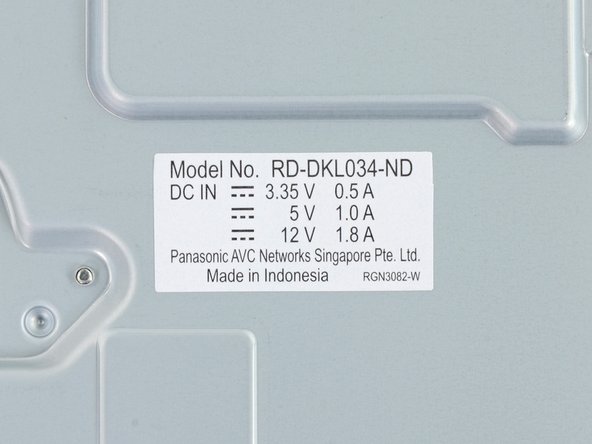

  6. Nintendo Wii U Teardown: crwdns2935265:06crwdnd2935265:01crwdnd2935265:03crwdne2935265:0 Nintendo Wii U Teardown: crwdns2935265:06crwdnd2935265:02crwdnd2935265:03crwdne2935265:0 Nintendo Wii U Teardown: crwdns2935265:06crwdnd2935265:03crwdnd2935265:03crwdne2935265:0
    • Hmmm… This optical drive feels really heavy. It appears much larger than most optical drives, so we take it to the scales!
    • 424.2 grams! That means that the optical drive accounts for nearly a third of the 1.5-kg device.
    • We suspect that the large optical drive may be a by-product of the larger motherboard underneath. A case expansive enough to accommodate the motherboard leaves some extra room for a bigger optical drive.
    • Possible benefits to using a clunkier disc-reader could be reduced cost, quieter operation, or improved longevity over a slimmer drive.

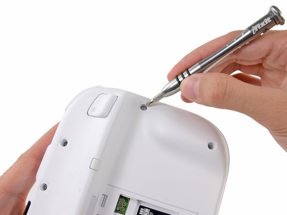

    • Nintendo. You're silly. Trying to hide your screws from us? Though clever, the screws are still hiding in plain sight.
    • A deca-plethora of hidden and recessed Tri-point screws are inevitably no match for our trusty tools. Some of the screws are very recessed, forcing us to use the included 4 mm nut driver attachment to extend the length of our 54 Bit Driver. It works perfectly, and we are in!

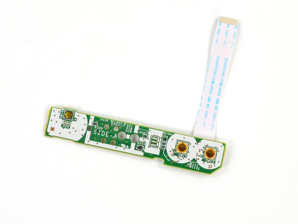

  17. Nintendo Wii U Teardown: crwdns2935265:017crwdnd2935265:01crwdnd2935265:03crwdne2935265:0 Nintendo Wii U Teardown: crwdns2935265:017crwdnd2935265:02crwdnd2935265:03crwdne2935265:0 Nintendo Wii U Teardown: crwdns2935265:017crwdnd2935265:03crwdnd2935265:03crwdne2935265:0
    • A simple ZIF connector stands between us and the bottom button board.
    • The bottom button board is home to the TV control and power buttons.
    • Despite the board housing two of the most important buttons, there are no conspicuous ICs on the bottom button board.
  18. Nintendo Wii U Teardown: crwdns2935265:018crwdnd2935265:01crwdnd2935265:02crwdne2935265:0 Nintendo Wii U Teardown: crwdns2935265:018crwdnd2935265:02crwdnd2935265:02crwdne2935265:0
    • This button casing is wrapped in blue ribbon cables and switches for the ABXY button pad.
    • With the button casing out of the way, we get to the first of the dual analog joysticks.

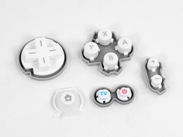

  20. Nintendo Wii U Teardown: crwdns2935265:020crwdnd2935265:01crwdnd2935265:02crwdne2935265:0 Nintendo Wii U Teardown: crwdns2935265:020crwdnd2935265:02crwdnd2935265:02crwdne2935265:0
    • Button, button, who's got the button? The U doesn't...well, not anymore.
    • The rubber backed ABXY, D-pad, start/select, Power, TV, and Home buttons coming flying out of the Wii U.
    • Separate button groups are good news for the button mashers among us, as each unit will be relatively quick and inexpensive to replace.

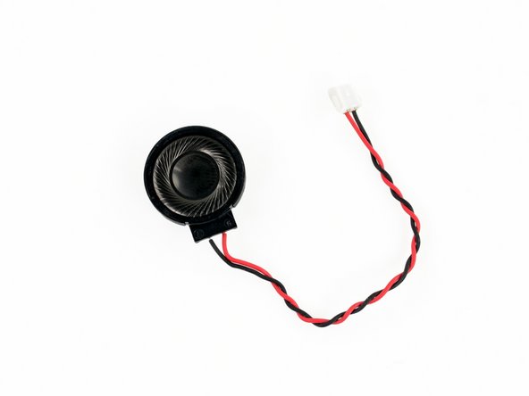

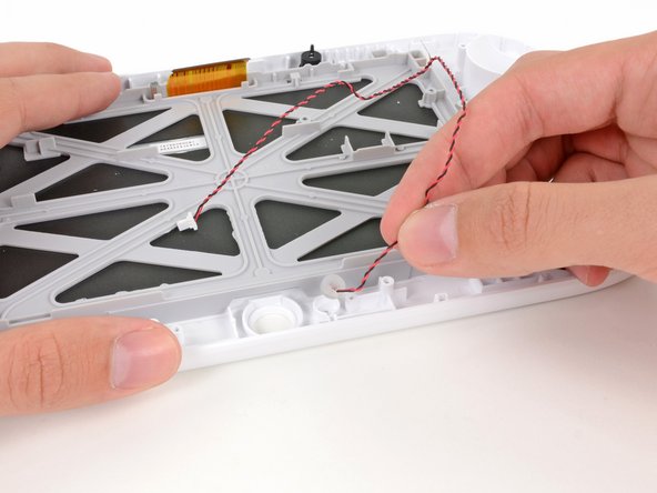

  26. Nintendo Wii U Teardown: crwdns2935265:026crwdnd2935265:01crwdnd2935265:03crwdne2935265:0 Nintendo Wii U Teardown: crwdns2935265:026crwdnd2935265:02crwdnd2935265:03crwdne2935265:0 Nintendo Wii U Teardown: crwdns2935265:026crwdnd2935265:03crwdnd2935265:03crwdne2935265:0
    • Just a few more components block our path to the 6.2-inch touch screen display.
    • First out are the dual antennas that transfer the GamePad controller's wireless signal back to the Wii U console.
    • The microphone and remaining speaker were previously blocked in place underneath the motherboard, but are now easily removed.

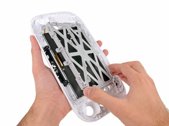

  27. Nintendo Wii U Teardown: crwdns2935265:027crwdnd2935265:01crwdnd2935265:02crwdne2935265:0 Nintendo Wii U Teardown: crwdns2935265:027crwdnd2935265:02crwdnd2935265:02crwdne2935265:0
    • The big plastic pieces are getting a bit cliché as we remove yet another.
    • The bracket between the screen and the rest of the internals is held in place by standard Phillips #00 screws. Wii cheer for repairability!

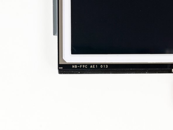

  28. Nintendo Wii U Teardown: crwdns2935265:028crwdnd2935265:01crwdnd2935265:03crwdne2935265:0 Nintendo Wii U Teardown: crwdns2935265:028crwdnd2935265:02crwdnd2935265:03crwdne2935265:0 Nintendo Wii U Teardown: crwdns2935265:028crwdnd2935265:03crwdnd2935265:03crwdne2935265:0
    • In what can only be hailed as a win for repair enthusiasts, the display assembly lifts off the GamePad's front case without any resistance from adhesive.
    • However, it seems the LCD is fused to the digitizer. Oh well, you win some, you lose some.
    • The display assembly is labeled as NB-F9C AE1 013.
