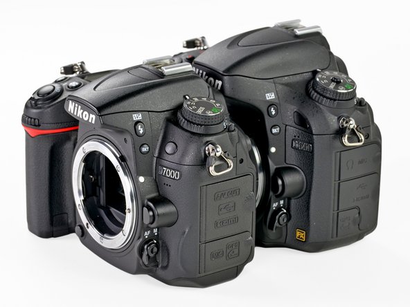

  4. Nikon D600 Teardown: crwdns2935265:04crwdnd2935265:01crwdnd2935265:02crwdne2935265:0 Nikon D600 Teardown: crwdns2935265:04crwdnd2935265:02crwdnd2935265:02crwdne2935265:0
    • If you're used to wielding a Nikon D7000, holding a D600 may start to feel like déjà vu. Let's compare the two and see how similar they really are.
    • Even without the different exterior markings, distinguishing the D600 from the D7000 is pretty easy once the body cap is removed, exposing the comparatively gigantic viewfinder mirror.
    • A shot of the camera controls reveals very similar button counts, button locations, and button functions.
  5. Nikon D600 Teardown: crwdns2935265:05crwdnd2935265:01crwdnd2935265:03crwdne2935265:0 Nikon D600 Teardown: crwdns2935265:05crwdnd2935265:02crwdnd2935265:03crwdne2935265:0 Nikon D600 Teardown: crwdns2935265:05crwdnd2935265:03crwdnd2935265:03crwdne2935265:0
    • The D600 seems to have a slight size advantage, but how slight is "slight?"
    • Check out this shot of what appears to be the D7000 by itself. Look closer, though, and you will notice that the D600 hides quite nicely behind the similarly sized D7000. Apparently "slight" really is slight!
    • Do not get the two cameras confused, though. They may look simlar on the outside, but the full-frame sensor in the D600 will certainly raise the bar as far as photo quality goes.

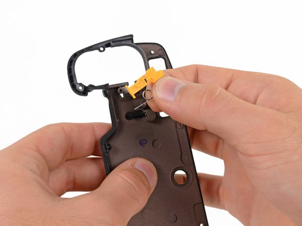

  8. Nikon D600 Teardown: crwdns2935265:08crwdnd2935265:01crwdnd2935265:03crwdne2935265:0 Nikon D600 Teardown: crwdns2935265:08crwdnd2935265:02crwdnd2935265:03crwdne2935265:0 Nikon D600 Teardown: crwdns2935265:08crwdnd2935265:03crwdnd2935265:03crwdne2935265:0
    • Several Phillips screws hold the bottom cover in place.
    • Poof! Like magic, the screws are released and we gain our first glimpse of the D600's insides.
    • The only goodie on the underside of the bottom case is the battery release mechanism. If—for whatever reason—yours fails, it can be replaced pretty easily.

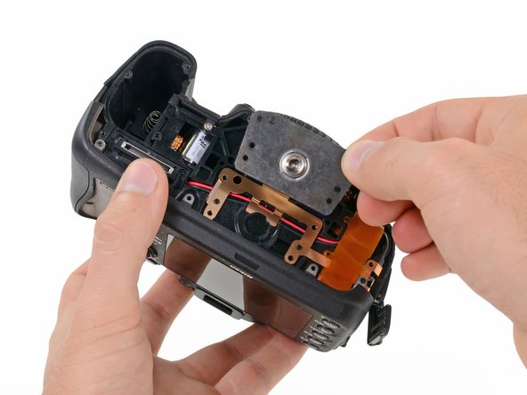

    • As we continue to remove parts, we get to the standard tripod mount, held in securely by four Phillips #00 screws.
    • It's nice to see that this mount comes out separately from the rest of the body. It would be a shame to compromise a $2,100 camera just because the tripod mount becomes cross-threaded.

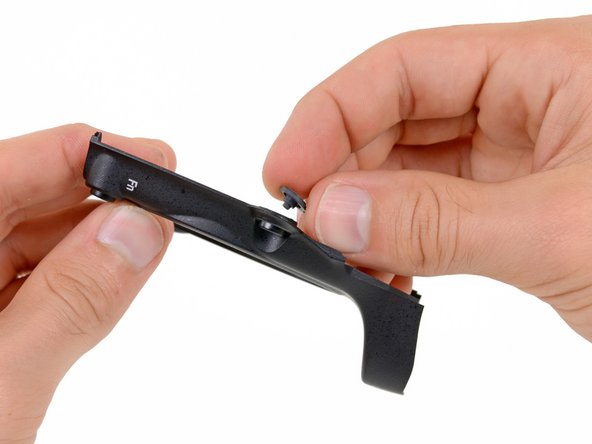

    • The front case is the next piece to surrender its spot on the D600's body.
    • The depth-of-field preview and function buttons both lay inside the front case underneath two rubber covers.
    • Though not a common repair, replacing these buttons is certainly feasible.

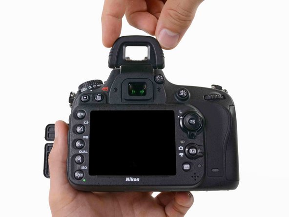

    • The rear cover is secured by a few sneakily-hidden screws.
    • How hidden are these screws? We found them underneath the eye cup, rubber grip, and viewfinder diopter dial.

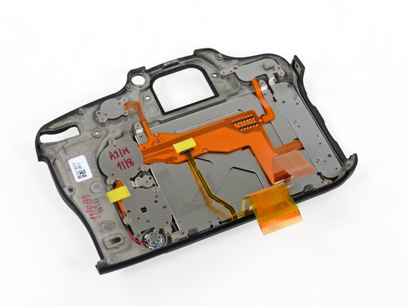

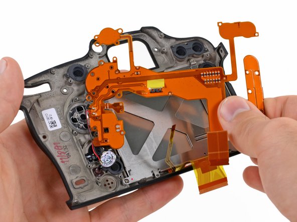

    • The rear cover (along with the LCD assembly) finally gives in and jumps ship from the rest of the body.
    • Well, this is nifty. Notice the red dots drawn on the inside of the rear cover? Each dot seems to correspond to the location of a screw. We assume this is done to keep track of each screw during the manufacturing process.
    • Every button on the rear cover is tied to a single ribbon cable. This makes repair a bit more costly if a single switch gets fried.

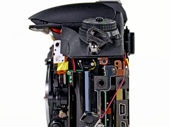

  15. Nikon D600 Teardown: crwdns2935265:015crwdnd2935265:01crwdnd2935265:03crwdne2935265:0 Nikon D600 Teardown: crwdns2935265:015crwdnd2935265:02crwdnd2935265:03crwdne2935265:0 Nikon D600 Teardown: crwdns2935265:015crwdnd2935265:03crwdnd2935265:03crwdne2935265:0
    • Bit by bit, we pull off the last few pieces of the outer case, revealing—no surprises here—more shields and circuit boards surrounding the ports and SD card slots.
    • Fast forward a bit, and you can see that this device is totally full of shields and grounding straps—that's not even all of them!

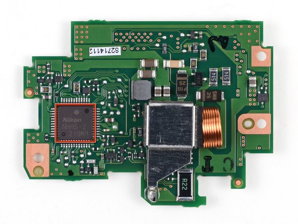

  17. Nikon D600 Teardown: crwdns2935265:017crwdnd2935265:01crwdnd2935265:02crwdne2935265:0 Nikon D600 Teardown: crwdns2935265:017crwdnd2935265:02crwdnd2935265:02crwdne2935265:0
    • 17 steps in and we've got our hands on some green! The first board out is the top case button board.
    • I see, you see, we all see an IC!
    • Nikon NHHS-2 219MM

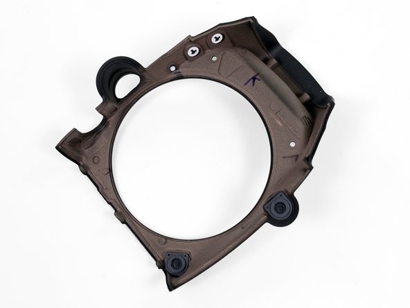

  18. Nikon D600 Teardown: crwdns2935265:018crwdnd2935265:01crwdnd2935265:03crwdne2935265:0 Nikon D600 Teardown: crwdns2935265:018crwdnd2935265:02crwdnd2935265:03crwdne2935265:0 Nikon D600 Teardown: crwdns2935265:018crwdnd2935265:03crwdnd2935265:03crwdne2935265:0

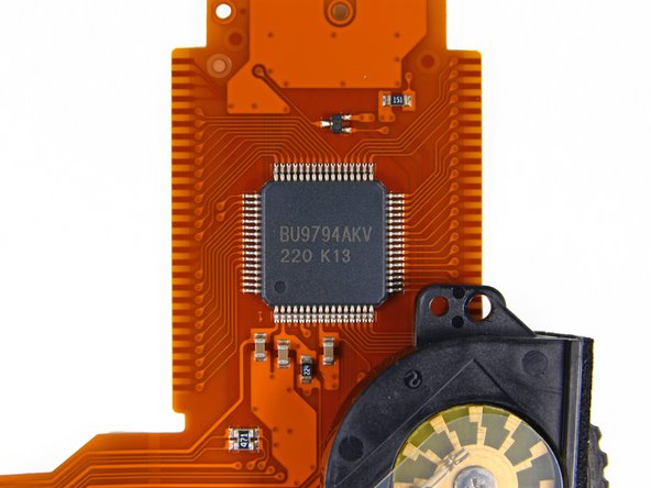

    • Under the board lay a few more goodies, the first of which is the upper LCD assembly.
    • Not surprisingly, the D600 sports the same wide viewing angle upper TFT-LCD as the D7000.
    • We find the LCD controller, ROHM segment driver BU9794AKV.
    • We could probably write an entire teardown for the top case of the D600 alone, but we decided to spare you. Take our word for it, there's a lot of stuff crammed in there.

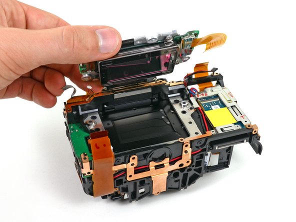

    • At this point we'd like to stop and let you appreciate the space management that goes into designing a DSLR camera. Wires and ribbon cables run amuck, yet everything works together in perfect harmony, allowing you to express your artistic vision with the press of a button.
    • With the number of screws left in the upper case roughly over 9000, we decide to divert our attention to the rest of the device.

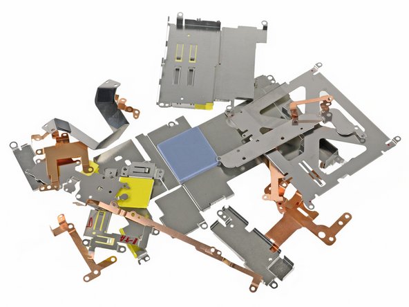

  20. Nikon D600 Teardown: crwdns2935265:020crwdnd2935265:01crwdnd2935265:02crwdne2935265:0 Nikon D600 Teardown: crwdns2935265:020crwdnd2935265:02crwdnd2935265:02crwdne2935265:0
    Spudger
    $3.99
    • EMI shields are very helpful. They work wonders in preventing external electromagnetic induction and radiation from messing with the circuitry of electronics.
    • That being said, they're usually a huge pain in the spudger to remove.
    • Luckily, this large EMI shield is removed by simply unscrewing some Phillips screws, and does not require any desoldering.
    • The large square of thermal compound also tips us off that this shield works double duty as a heat sink, removing any excess heat from the D600's motherboard.

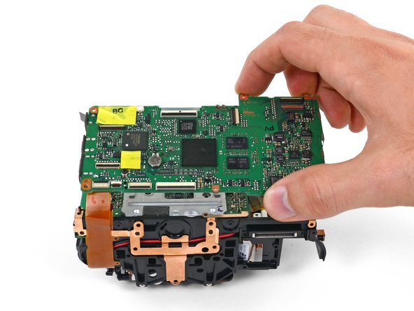

  21. Nikon D600 Teardown: crwdns2935265:021crwdnd2935265:01crwdnd2935265:02crwdne2935265:0 Nikon D600 Teardown: crwdns2935265:021crwdnd2935265:02crwdnd2935265:02crwdne2935265:0

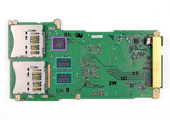

    • Motherboard!
    • Toshiba 80 MHz TMP19A44F10XBG low-power microcontroller
    • Nikon EL-166
    • Nikon EL175 1207 EXPEED 3 image processing engine
    • Samsung K4B2G0846D 1 GB (total) DDR 3 SDRAM
    • Inrevium TE4302RX SD controller, provides UHS-I, Ultra High Speed SD card read/write support
    • Spansion GL128S90DHI02 16 MB flash memory

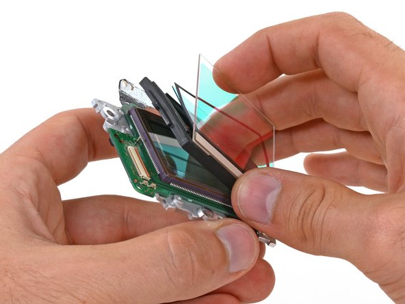

    • To get a closer look at the full-frame CMOS sensor, we remove the frame and layers of filters covering it.
    • Curious what all of these filters do? So were we! Luckily, Nikon breaks it down for us quite nicely.

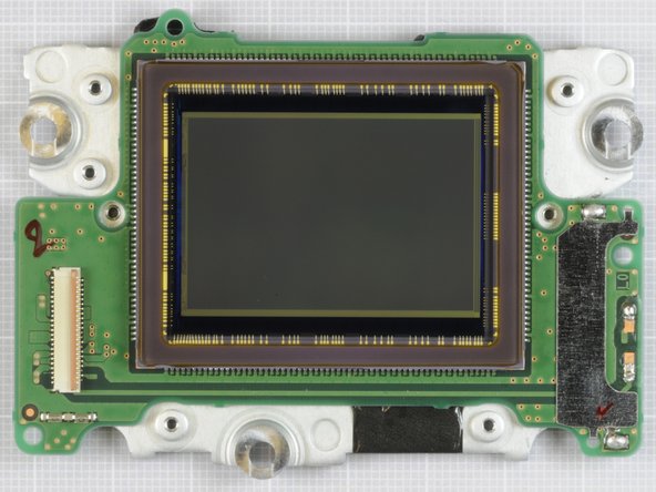

  24. Nikon D600 Teardown: crwdns2935265:024crwdnd2935265:01crwdnd2935265:03crwdne2935265:0 Nikon D600 Teardown: crwdns2935265:024crwdnd2935265:02crwdnd2935265:03crwdne2935265:0 Nikon D600 Teardown: crwdns2935265:024crwdnd2935265:03crwdnd2935265:03crwdne2935265:0
    • With the filters off, we get a full-frontal view of the full-frame image sensor. The 35.9mm x 24.0mm sensor is a major size upgrade from the 23.6mm x 15.6mm sensor in the D7000, and accounts for a 50% increase in total effective pixels (24 million/16 million).
    • The full-frame image sensor courtesy of Chipworks!

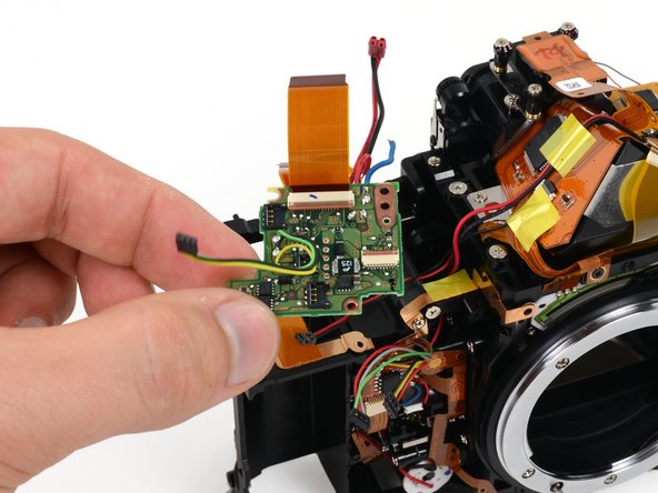

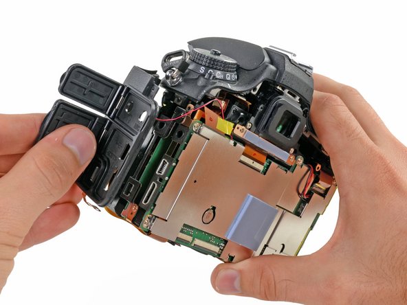

    • And now.... desoldering time!
    • With the help of our soldering station, we free the secondary power board from the D600.
    • It's not at all uncommon for the various daughterboards inside a camera to be soldered together. Connections need to be sturdy and not take up a lot of space, and surface mount soldering fits the criteria very well.

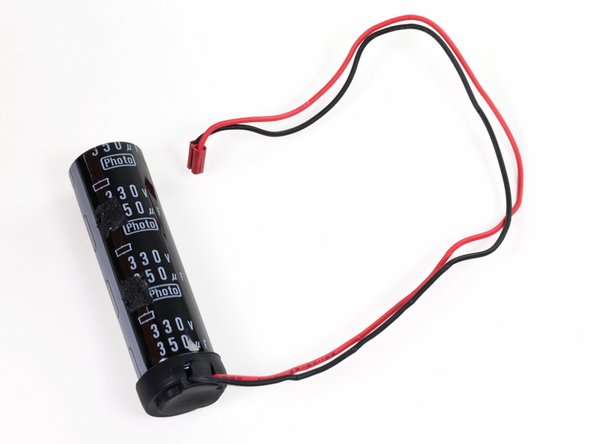

  29. Nikon D600 Teardown: crwdns2935265:029crwdnd2935265:01crwdnd2935265:02crwdne2935265:0 Nikon D600 Teardown: crwdns2935265:029crwdnd2935265:02crwdnd2935265:02crwdne2935265:0
    • We were relieved to find an insulated rubber cover on the beefy 350 µF flash capacitor, protecting us against what could have been a dangerous shock.
    • Just in case it wasn't so welcoming, we were ready with our capacitor discharge tool—always a good idea when you're dealing with large electrolytic capacitors.

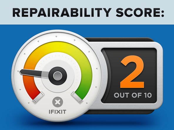

    • Nikon D600 Repairability Score: 2 out of 10 (10 is easiest to repair)
    • The battery can be easily replaced by opening the compartment with your thumbnail.
    • The tripod mount comes off after removing four Phillips #00 screws.
    • The D600 has several wires that need to be desoldered in order to take it apart.
    • Many, many screws hold the device together.
    • The LCD is fused to the rear case, and cannot be swapped without replacing the entire back of the camera.
    • For absolute safety, you need to discharge the flash capacitor, otherwise you risk accidentally killing your camera (or yourself).
