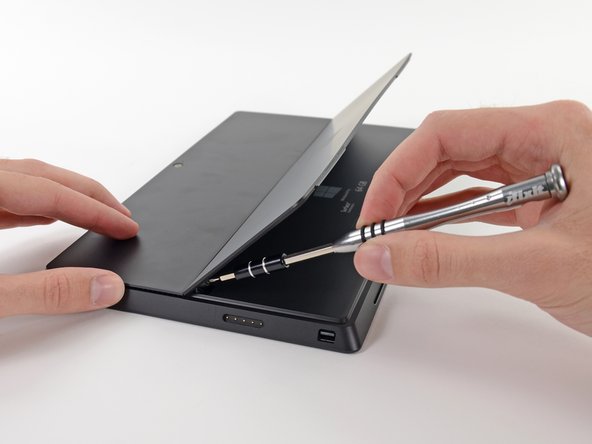

    • Just like last time, we lift the kickstand and let the Surface reveal its secrets.
    • What wisdom does this Pro have for us?
    • "Surface | 64 GB | Model 1514 | Made in China." Also, great news: this device complies with part 15 of the FCC Rules. Good to know.
    • 64 GB of storage? Where we're going, we don't need storage.
    • …which is good, since the operating system takes up over half of those 64 gigs! (More on that later.)
    • We begin our trip back into the land of torn down devices; we first use our trusty T5 Torx screwdriver to pull out two screws securing the kickstand to its hinges.

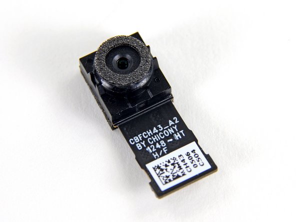

    • With the gluey plastic bezel clear of the device, we gain access to the front-facing camera.
    • While this 720p HD "LifeCam with TrueColor" is nothing to write home about, it's on par with both the MacBook Air and iPad's front-facing cams.

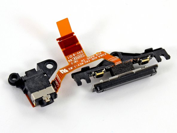

    • We use our ESD-safe tweezers to safely remove the volume buttons and headphone jack, which are tied together in a neat package by a ribbon cable.
    • So much for listening to the Pro's Grammy commercial.

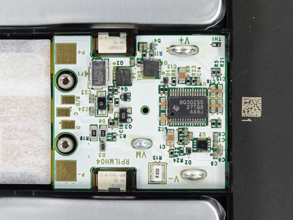

    • Microsoft spared no expense when it came to keeping the Surface Pro going. They sourced the Cadillac of batteries from LG: an Escalade 42 Wh unit. The battery is rated for 7.4 V and 5676 mAh.
    • Impressive specs? Note that the iPad 4 has a 43 Wh battery, albeit at 3.7 V.
    • And even with all this battery juice, the reported battery life of the Surface Pro is less than 5 hours.
