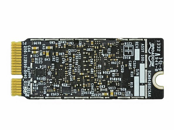

  5. MacBook Pro 13" Retina Display Late 2013 Teardown: crwdns2935265:05crwdnd2935265:01crwdnd2935265:03crwdne2935265:0 MacBook Pro 13" Retina Display Late 2013 Teardown: crwdns2935265:05crwdnd2935265:02crwdnd2935265:03crwdne2935265:0 MacBook Pro 13" Retina Display Late 2013 Teardown: crwdns2935265:05crwdnd2935265:03crwdnd2935265:03crwdne2935265:0
    • We spudger our way through the antenna cables and extract the slumbering AirPort card.
    • Don't worry—we promise to put it back before it wakes up.
    • It may reside in the same right-side location as ye olde model, but this here Broadcom BCM94360CS is a different animal.
    • New 802.11ac Wi-Fi tech claims triple the performance of 802.11n.

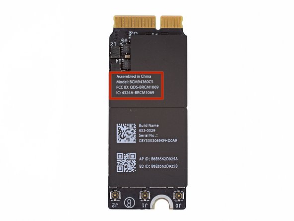

  6. MacBook Pro 13" Retina Display Late 2013 Teardown: crwdns2935265:06crwdnd2935265:01crwdnd2935265:02crwdne2935265:0 MacBook Pro 13" Retina Display Late 2013 Teardown: crwdns2935265:06crwdnd2935265:02crwdnd2935265:02crwdne2935265:0
    • Taking a peek under the covers of the revised AirPort Card, we find:
    • Broadcom BCM4360 5G Wi-Fi 3-Stream 802.11ac Gigabit Transceiver
    • Broadcom BCM20702 Single-Chip Bluetooth Processor with a High Performance Integrated 2.4-GHz RF Transceiver
    • Skyworks SE5516 Dual-Band 802.11a/b/g/n/ac WLAN Front-End Module

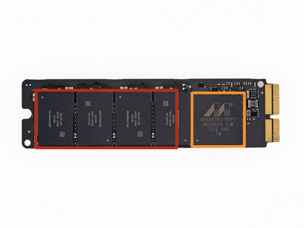

  7. MacBook Pro 13" Retina Display Late 2013 Teardown: crwdns2935265:07crwdnd2935265:01crwdnd2935265:03crwdne2935265:0 MacBook Pro 13" Retina Display Late 2013 Teardown: crwdns2935265:07crwdnd2935265:02crwdnd2935265:03crwdne2935265:0 MacBook Pro 13" Retina Display Late 2013 Teardown: crwdns2935265:07crwdnd2935265:03crwdnd2935265:03crwdne2935265:0
    • SSDs may not spin like other hard-disk drives, but the one in the 13" MacBook Pro Retina sure does like to hop around!
    • This Pro comes with a base 128 GB of flash storage, with the larger models sporting 256 or 512 GB.
    • Apple notes that the 512 GB model is configurable up to 1 TB of storage, just in case your kitten archives won't fit on the dinky 512 GB SSD.
    • Notable bits and pieces:
    • SanDisk 05131 016G 16 GB NAND Flash (total of 8 x 16 GB = 128 GB)
    • Marvell Semiconductor 88SS9183 SSD Controller
    • SK Hynix H5TQ2G63DFR DDR3-1600

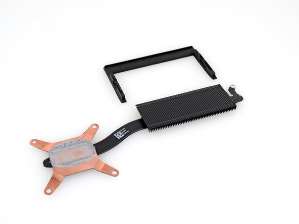

    • We spudge off some sticky foam screw coverings and remove the heat sink to find...goopy thermal paste.
    • As Apple rolls out Intel's new Haswell processors and Iris Graphics, we're seeing a massive heat sink consolidation trend making for a cleaner and more streamlined design.
    • The CPU and GPU share the same large die on the right, and the southbridge(PCH) on the left
  12. MacBook Pro 13" Retina Display Late 2013 Teardown: crwdns2935265:012crwdnd2935265:01crwdnd2935265:03crwdne2935265:0 MacBook Pro 13" Retina Display Late 2013 Teardown: crwdns2935265:012crwdnd2935265:02crwdnd2935265:03crwdne2935265:0 MacBook Pro 13" Retina Display Late 2013 Teardown: crwdns2935265:012crwdnd2935265:03crwdnd2935265:03crwdne2935265:0

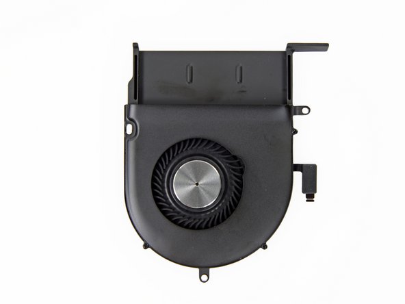

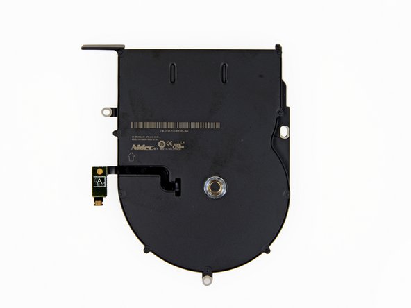

    • With the heat sink gone, it's time to cool off! Well, time to take the fan off at least.
    • The brushless Nidec fan isn't blowing us away with any new innovations, but we appreciate its efforts to keep things from boiling over.

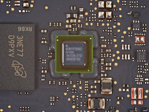

  16. MacBook Pro 13" Retina Display Late 2013 Teardown: crwdns2935265:016crwdnd2935265:01crwdnd2935265:02crwdne2935265:0 MacBook Pro 13" Retina Display Late 2013 Teardown: crwdns2935265:016crwdnd2935265:02crwdnd2935265:02crwdne2935265:0
    • Back side of logic board:
    • Micron D9PXV 4 Gb (512 MB) DDR3L SDRAM
    • MXIC MX25L6406E 64M-bit CMOS Serial Flash
    • Texas Instruments Stellaris LM4FS1EH Microcontroller
    • Cypress CY8C24794-24LTXI Programmable System-on-Chip
    • Broadcom BCM15700A2
    • P13WVR 12612NEE
    • Linear Technology LT3957 B29255

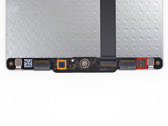

    • We already coaxed the battery from its gooey perch above the trackpad; does this metal plate really think it can slow us down?
    • Don't worry—steel is weak to fire—we attack with iOpener; it's super effective!
    • Under that hefty metal armor, we find much the same trackpad as in the 2012 edition.
    • ICs include:
    • Macronix MX25L2006E 16M-bit CMOS Serial Flash
    • Broadcom BCM5976 Touchscreen Controller (as found in the earlier versions and the iPhone 5)

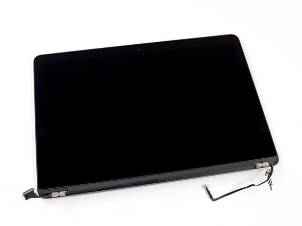

    • The usual black rubber conceals the display hinge screws and some new adhesive.
    • Hey Apple, do you think next time you could mark up the screws removed during display replacement? You were so close this time.
    • We let this display off with a warning, but if you're dying to see inside, how about a blast from the past?
    • This display, as with its predecessors, must be replaced as an assembly; there's no parting out this bad boy.
