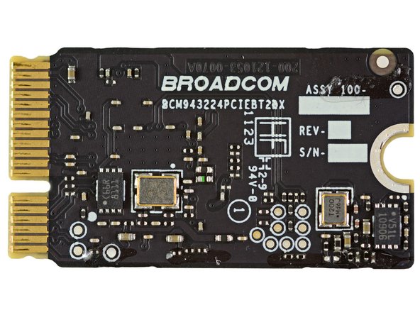

    • We've uncovered the Wi-Fi/Bluetooth board in the MacBook Air.
    • After disconnecting the antennas and removing a single T5 Torx screw, the board lifts out easily.
  7. MacBook Air 13" Mid 2011 Teardown: crwdns2935265:07crwdnd2935265:01crwdnd2935265:02crwdne2935265:0 MacBook Air 13" Mid 2011 Teardown: crwdns2935265:07crwdnd2935265:02crwdnd2935265:02crwdne2935265:0
    • The main chips on the mini-PCIe wireless card include:
    • Broadcom BCM4322 Intensi-fi® Single-Chip 802.11n Wi-Fi Transceiver
    • Broadcom BCM20702 Single-Chip Bluetooth 4.0 Processor with Bluetooth Low Energy (BLE) support
    • BLE chips hold many advantages over classic Bluetooth including 128 bit AES security, 6 ms latency (classic Bluetooth is 100 ms), and less power consumption.
    • It's interesting that there's a spot for stamping the revision and serial number, but that Apple chose not to stamp a unique number on it.

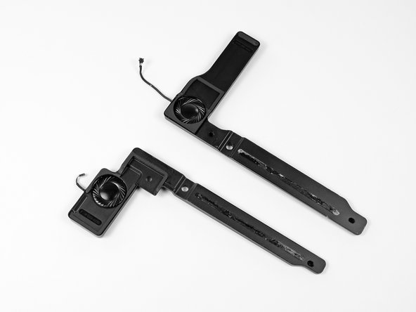

  15. MacBook Air 13" Mid 2011 Teardown: crwdns2935265:015crwdnd2935265:01crwdnd2935265:02crwdne2935265:0 MacBook Air 13" Mid 2011 Teardown: crwdns2935265:015crwdnd2935265:02crwdnd2935265:02crwdne2935265:0
    • The speakers are stuck down to the upper case with some adhesive and can be easily removed.
    • Nothing new to see here.
    • We've been impressed with the audio quality in Apple's mobile devices lately. High sound quality from such small speaker cones can be attributed to carefully tuning the speaker enclosure to maximize sound output, hence their odd L-shape.

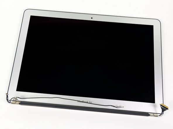

  16. MacBook Air 13" Mid 2011 Teardown: crwdns2935265:016crwdnd2935265:01crwdnd2935265:02crwdne2935265:0 MacBook Air 13" Mid 2011 Teardown: crwdns2935265:016crwdnd2935265:02crwdnd2935265:02crwdne2935265:0
    • After cranking out a few T8 Torx screws, the display can be removed from the upper case.
    • This Air is equipped with the same 1440 x 900 LED backlit display as the previous 13" Air.
    • The thickness restriction of such a thin display was the deciding factor in equipping the Air with a 640x480 FaceTime camera instead of the 1280x1024 FaceTimeHD model.
