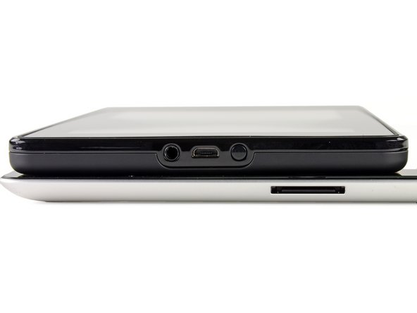

  3. Kindle Fire Teardown: crwdns2935265:03crwdnd2935265:01crwdnd2935265:03crwdne2935265:0 Kindle Fire Teardown: crwdns2935265:03crwdnd2935265:02crwdnd2935265:03crwdne2935265:0 Kindle Fire Teardown: crwdns2935265:03crwdnd2935265:03crwdnd2935265:03crwdne2935265:0
    • The Fire has a very simplified design that includes a mere two ports and one button—all found on the bottom of the device.
    • The first port is a standard 3.5mm headphone jack, but the volume must be controlled from inside each app, as there are no external volume buttons.
    • The port in the middle is a Micro-USB port for connecting the Fire to your computer. The Fire can also charge its battery when plugged into a computer, though it will take longer than charging directly from the AC outlet.
    • The only button on this tablet is a power button, located on the bottom of the Fire right next to the ports.
    • The Kindle Fire has a similar port configuration as the iPad 2, utilizing only a single port for data transfer and charging.
    • The Fire's dimensions are 7.5" x 4.7" x 0.45". Compared to the iPad 2 whose dimensions are 9.5" x 7.3" x 0.34", the Fire looks a little like a chew-toy for the much larger iPad 2.

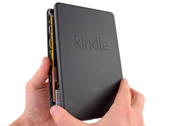

  4. Kindle Fire Teardown: crwdns2935265:04crwdnd2935265:01crwdnd2935265:03crwdne2935265:0 Kindle Fire Teardown: crwdns2935265:04crwdnd2935265:02crwdnd2935265:03crwdne2935265:0 Kindle Fire Teardown: crwdns2935265:04crwdnd2935265:03crwdnd2935265:03crwdne2935265:0
    iFixit Opening Picks (Set of 6)
    • Our old friend, plastic opening tool, comes to our aid as well as our musical friend, the guitar pick.
    • A little prying and plucking and the case's halves yield to our efforts.
    • Thankfully the Kindle's case separates with a lot less effort than a certain product line we know.
    • Removing the back case reveals the motherboard and a behemoth of a battery. Note the shiny metal plates on the back case that help provide protection for the internal components, as well as heat sinking and EMI shielding. Unfortunately, this mirror-like shielding inevitably results in a narcissistic battery.

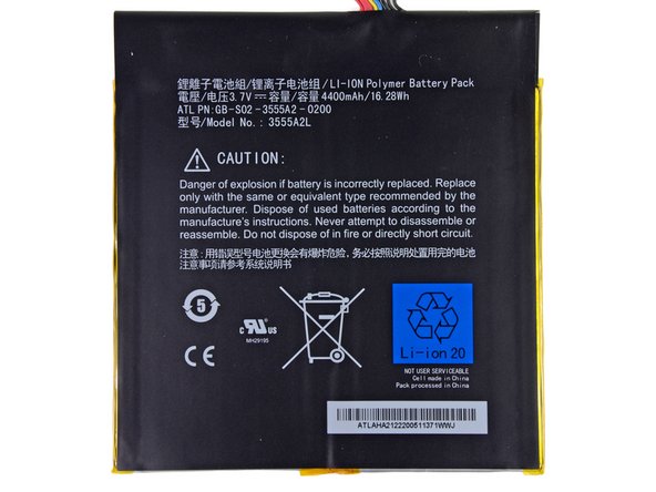

  5. Kindle Fire Teardown: crwdns2935265:05crwdnd2935265:01crwdnd2935265:03crwdne2935265:0 Kindle Fire Teardown: crwdns2935265:05crwdnd2935265:02crwdnd2935265:03crwdne2935265:0 Kindle Fire Teardown: crwdns2935265:05crwdnd2935265:03crwdnd2935265:03crwdne2935265:0
    Spudger
    $3.99
    • Only one connector and some glue keep this monstrous battery in its place—no match for our trusty spudger and plastic opening tool.
    • With the battery freed, we take a closer look at the Fire's 4.6" tall x 4.3" wide Li-Ion battery.
    • This battery sure puts out... 16.28 Watt-hours, to be exact. However, due to the size of the Fire, its battery's 3.7 V potential and 4400 mAh capacity don't quite stack up to the specs of the iPad 2 Wi-Fi's battery.

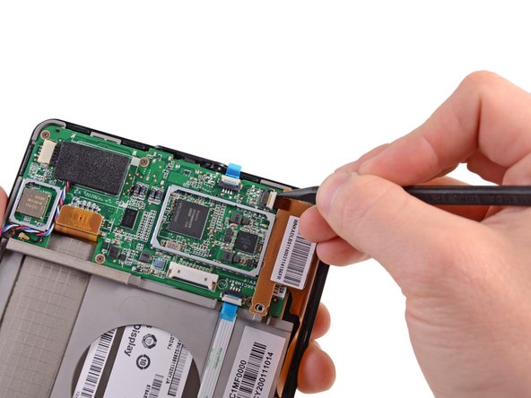

  6. Kindle Fire Teardown: crwdns2935265:06crwdnd2935265:01crwdnd2935265:02crwdne2935265:0 Kindle Fire Teardown: crwdns2935265:06crwdnd2935265:02crwdnd2935265:02crwdne2935265:0
    • The touchscreen controller is easily detached from the motherboard after removing a few screws.
    • To gain access to the motherboard, we must first disconnect a couple of connectors from their respective sockets.

  7. Kindle Fire Teardown: crwdns2935265:07crwdnd2935265:01crwdnd2935265:02crwdne2935265:0 Kindle Fire Teardown: crwdns2935265:07crwdnd2935265:02crwdnd2935265:02crwdne2935265:0
    • A few more twists with the Phillips #0 from our 64 Bit Driver Kit releases the motherboard from the Kindle's grasp.

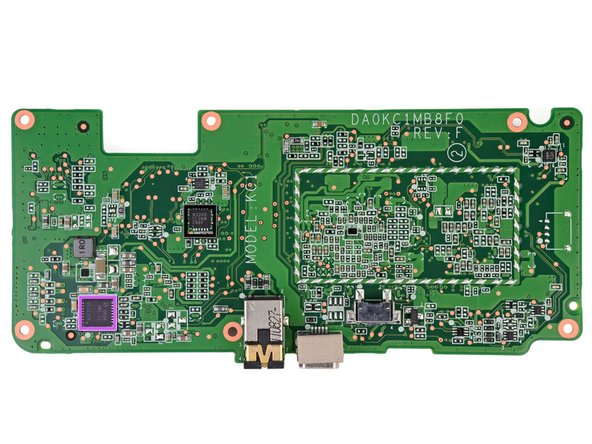

  8. Kindle Fire Teardown: crwdns2935265:08crwdnd2935265:01crwdnd2935265:02crwdne2935265:0 Kindle Fire Teardown: crwdns2935265:08crwdnd2935265:02crwdnd2935265:02crwdne2935265:0
    • We put on our classy monocle magnifying glass to help us identify the ICs:
    • Samsung KLM8G2FEJA 8 GB Flash Memory
    • Hynix H9TKNNN4K 512 MB of Mobile DDR2 RAM
    • Texas Instruments 603B107 Fully Integrated Power Management IC with Switch Mode Charger
    • Texas Instruments LVDS83B FlatLink 10-135 MHz Transmitter
    • Jorjin WG7310 WLAN/BT/FM Combo Module
    • Texas Instruments AIC3110 Low-Power Audio Codec With 1.3W Stereo Class-D Speaker Amplifier
    • Texas Instruments WS245 4-Bit Dual-Supply Bus Transceiver
    Does the presence of the Jorjin WG7310 WLAN/BT/FM Combo Module indicate that the Fire is capable of Bluetooth in its hardware? If so, it'll be exciting to see if CyanogenMod can enable it -- as it did with the Nook Color.
    Karen Nakamura - crwdns2934203:0crwdne2934203:0
    Yes, it does - and there's been a lot of folks seeking this Holy Grail. No joy yet, though.
    bruceebennett -
    I hear that there is an internal micro SD card slot on the motherboard.
    Can you please outline which connector that it is?
    James Wrightsman - crwdns2934203:0crwdne2934203:0
    Mine is open - and I do not see any such thing.
    bruceebennett -
    Can the 8GB Samsung Flash Memory be swapped to retain previous data? Thanks! Jason

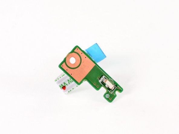

  11. Kindle Fire Teardown: crwdns2935265:011crwdnd2935265:01crwdnd2935265:02crwdne2935265:0 Kindle Fire Teardown: crwdns2935265:011crwdnd2935265:02crwdnd2935265:02crwdne2935265:0
    • One more screw holds the power status LED board in place.
    • The Kindle Fire's sole button (located on the motherboard) is used to turn the device on/off or tell it to sleep/wake.
    • Be careful telling your device what to do; we hear it has a fiery temper.

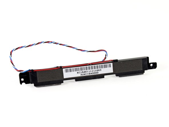

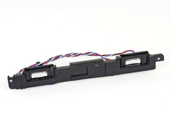

  12. Kindle Fire Teardown: crwdns2935265:012crwdnd2935265:01crwdnd2935265:03crwdne2935265:0 Kindle Fire Teardown: crwdns2935265:012crwdnd2935265:02crwdnd2935265:03crwdne2935265:0 Kindle Fire Teardown: crwdns2935265:012crwdnd2935265:03crwdnd2935265:03crwdne2935265:0
    • A couple more Phillips #0 screws are removed from the Fire and off comes the speaker assembly.
    • The speaker assembly seems about on par with the speaker assemblies of some other tablets.
    How many watts in speakers .
    Achraf52 - crwdns2934203:0crwdne2934203:0
    What is blue Ribbon cable? Is that a Flaxible Flat Cable?
    What type of that cable?
    Alex Shin - crwdns2934203:0crwdne2934203:0

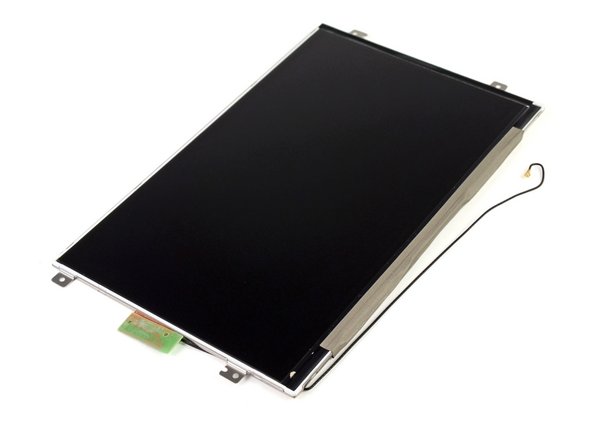

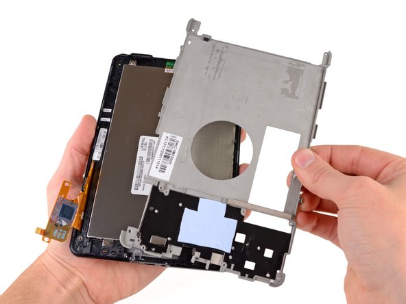

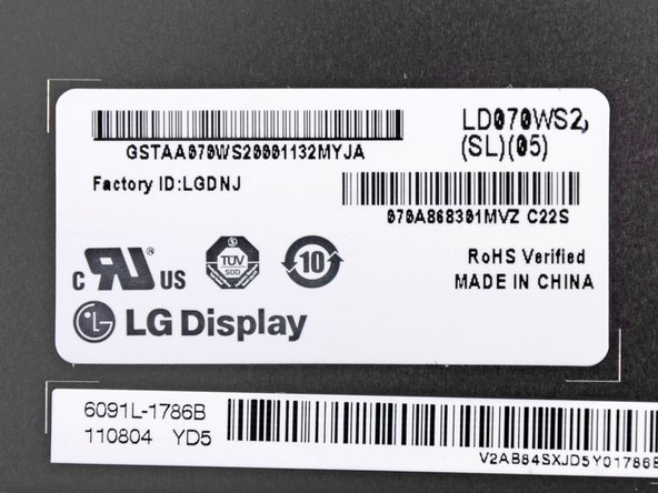

  14. Kindle Fire Teardown: crwdns2935265:014crwdnd2935265:01crwdnd2935265:03crwdne2935265:0 Kindle Fire Teardown: crwdns2935265:014crwdnd2935265:02crwdnd2935265:03crwdne2935265:0 Kindle Fire Teardown: crwdns2935265:014crwdnd2935265:03crwdnd2935265:03crwdne2935265:0
    • Separating the display from the glass was a breeze, which was a nice departure from the usual fused glass ordeals.
    • Don't be fooled by the display's current state of black lifelessness. When powered on, the LG-manufactured 7" (diagonal) display gives users an eye-pleasing array of 16 million colors at a resolution of 1024 x 600 pixels.
    • Sharing the screen with friends and family is made easy thanks to the application of In-Plane Switching (IPS) which allows for a wider viewing angle.
    • We may be comparing apples and oranges here, but the original Kindle contained roughly 15,999,996 fewer colors. They were as follows: gray-ish, gray, grayer, and grayest.

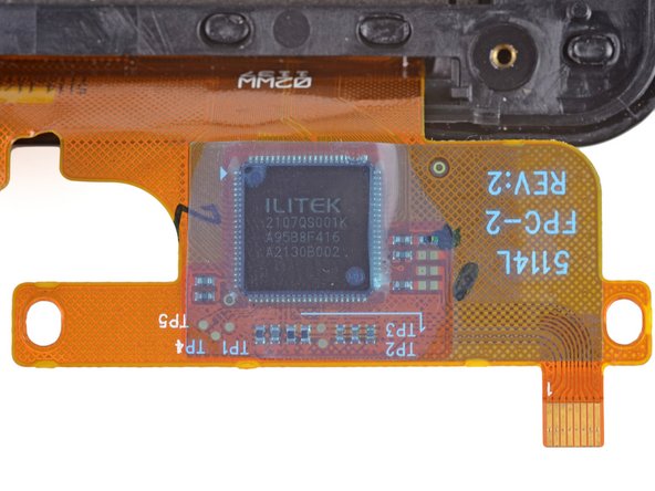

  15. Kindle Fire Teardown: crwdns2935265:015crwdnd2935265:01crwdnd2935265:02crwdne2935265:0 Kindle Fire Teardown: crwdns2935265:015crwdnd2935265:02crwdnd2935265:02crwdne2935265:0
    • Here we have the front panel assembly in all its glory.
    • The touchscreen controller is designed by ILITEK and is marked as 2107QS001K A95B8F416 A2130B002
    The audio plug evidently includes audio in. Standard 4 conductor (2 ch stereo out, 1 in like iPhone headset plug). Some audio apps apparently work okay with this.
    Tom Semple - crwdns2934203:0crwdne2934203:0
    The last two strings of the touchscreen controller identification seem to be batch-specific. Over at the TechRepublic is a nice picture of this piece as well and the last two strings are A95B9F695 A2135B010-20
    Source: http://www.techrepublic.com/photos/crack...
    masterjo - crwdns2934203:0crwdne2934203:0

This is great instruction. I appreciate the work involved in repairing a device like a tablet. I was able to follow the directions with ease and understood them, and now I have two questions; first, my charging port is supposed to have five connectors, I can only see three. It looks like the others were ripped away, and I actually found one piece floating around after opening the case, wasn't sure what it was until I got to the port, the question is where in the !&&* do find another port to replace.
Second question is I know the wires used to charge the battery are red and black, would anybody happen to which two they are? the connector has several colors, I only need to get power to the battery, so that i can charge it.
Bernard Doitch - crwdns2934203:0crwdne2934203:0
All of the black wires on the battery are connected together, and all of the red wires are connected together. However, charging a lithium battery is not so simple as connecting a power source and waiting a while. Excessive charging current or voltage can cause a nasty fire or explosion. The white, yellow and blue wires to the battery are for temperature sensor and possibly other monitoring circuitry. or sensors. It is not a good idea to bypass these.
If you are intent on manually charging the battery (for example, if it is discharged below the safety cutoff threshold and you want to try to salvage it, limit charge current to 0.08 Amps (80 mA), and absolutely do not let the voltage applied to the battery exceed 4.20 Volts. Watch the battery to make sure it does not overheat or swell; if it does, disconnect power immediately.
It’s much safer and easier to replace the broken USB jack and let the on-board power management chip take care of charge control.
