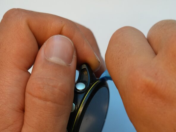

            Heat the watch using a heat gun. I tried using iOpener, didn't work. Heat the watch along the yellow strip, that's where the watch is glued together.

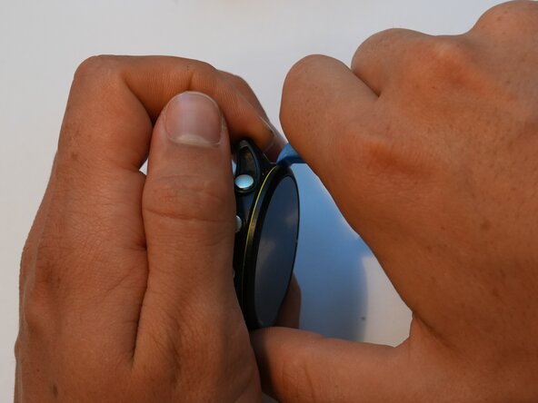

            Wedge the iFixit Opening Tool between the display part and the rest of the body. The strip around the watch (yellow in my case) is on the screen part of the case, so try to put the tool underneath it. If you can't put the tool between, try pulling on the screen part like in the picture. That worked best for me.
            Reheat the watch whenever it feels cold.
            When the screen is relatively loose, use iFixit Opening Pick to remove it completely. Circle around the watch with the tool and it'll come loose. The watch doesn't need to be very hot in this step - the screen doesn't hold very well anymore.
