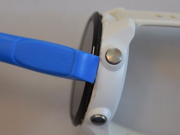

  4. Garmin Forerunner 245 Music Teardown, Attempt 2: Remove the combined screen and bezel via prying: crwdns2935265:04crwdnd2935265:01crwdnd2935265:03crwdne2935265:0 Garmin Forerunner 245 Music Teardown, Attempt 2: Remove the combined screen and bezel via prying: crwdns2935265:04crwdnd2935265:02crwdnd2935265:03crwdne2935265:0 Garmin Forerunner 245 Music Teardown, Attempt 2: Remove the combined screen and bezel via prying: crwdns2935265:04crwdnd2935265:03crwdnd2935265:03crwdne2935265:0
    iOpener
    $14.99
    • This method is likely to fail. If you cannot complete it successfully, move on to the (more destructive) next step.
    • Utilize your choice of iOpener, heat gun, hair dryer, oven, etc. to soften the internal glue.
    • Wedge your tool of choice (spudger, opening tool, knife, etc.) between the bezel brim and the rest of the watch body until you reach the wall of the plastic ring which hangs down from the bezel. Pry the watch face away from the watch body until the glue releases.
    • Be careful not to damage the FFC (flexible flat cable) connecting to the screen after separation.
    • You may need to cut some material away from the watch body or bezel brim in order to slide your tool in far enough to pry.

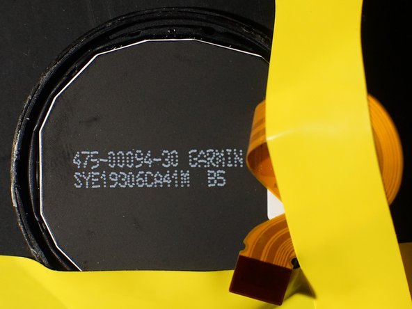

  7. Garmin Forerunner 245 Music Teardown, Screen closeups: crwdns2935265:07crwdnd2935265:01crwdnd2935265:03crwdne2935265:0 Garmin Forerunner 245 Music Teardown, Screen closeups: crwdns2935265:07crwdnd2935265:02crwdnd2935265:03crwdne2935265:0 Garmin Forerunner 245 Music Teardown, Screen closeups: crwdns2935265:07crwdnd2935265:03crwdnd2935265:03crwdne2935265:0
    • Insert wisdom here.

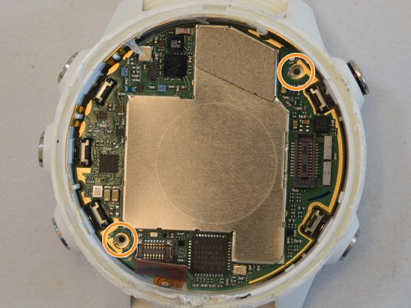

  8. Garmin Forerunner 245 Music Teardown, Remove the motherboard: crwdns2935265:08crwdnd2935265:01crwdnd2935265:03crwdne2935265:0 Garmin Forerunner 245 Music Teardown, Remove the motherboard: crwdns2935265:08crwdnd2935265:02crwdnd2935265:03crwdne2935265:0 Garmin Forerunner 245 Music Teardown, Remove the motherboard: crwdns2935265:08crwdnd2935265:03crwdnd2935265:03crwdne2935265:0
    • Undo and remove both of the T5 screws.
    • Turn the watch over so it is face down and let the motherboard fall out of the watch body.

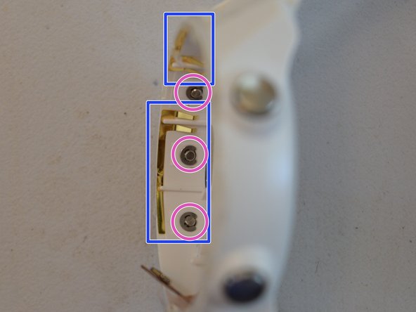

  9. Garmin Forerunner 245 Music Teardown, Parts identification (watch body): crwdns2935265:09crwdnd2935265:01crwdnd2935265:02crwdne2935265:0 Garmin Forerunner 245 Music Teardown, Parts identification (watch body): crwdns2935265:09crwdnd2935265:02crwdnd2935265:02crwdne2935265:0
    • Heart rate sensor
    • Vibration motor
    • Charging/USB contacts
    • Antennas
    • Waterproof button chambers

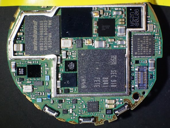

  10. Garmin Forerunner 245 Music Teardown, Component identification (outside of shielding): crwdns2935265:010crwdnd2935265:01crwdnd2935265:01crwdne2935265:0
    • ANT/BLE/BT coprocessor: Cypress CYW20719 datasheet
    • GPS coprocessor: Sony D5603 datasheet
    • RF front end: Qorvo (RF Micro Devices) RFFM6205 datasheet

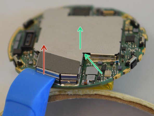

  11. Garmin Forerunner 245 Music Teardown, Remove shielding: crwdns2935265:011crwdnd2935265:01crwdnd2935265:03crwdne2935265:0 Garmin Forerunner 245 Music Teardown, Remove shielding: crwdns2935265:011crwdnd2935265:02crwdnd2935265:03crwdne2935265:0 Garmin Forerunner 245 Music Teardown, Remove shielding: crwdns2935265:011crwdnd2935265:03crwdnd2935265:03crwdne2935265:0
    • The sides of the metal shielding are clips which fit around the small metal walls underneath of them on the PCB. You can reach under the end of the clips and push up to remove them.
    • Alternatively, stick something small past the gap between clips and under the shielding, then use it to pull the shielding up.
    • Remove the 3M tape covering the rest of the components.

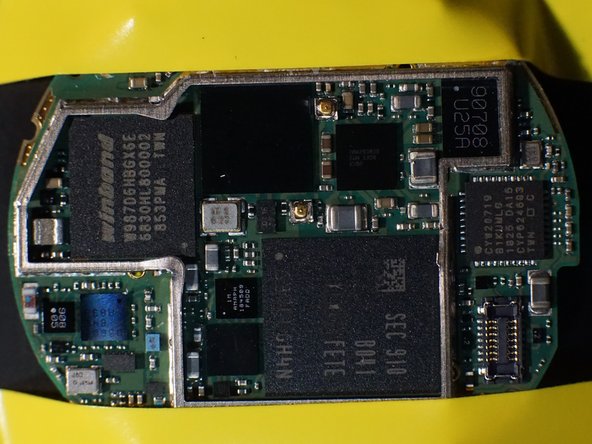

  12. Garmin Forerunner 245 Music Teardown, Component identification (inside of shielding): crwdns2935265:012crwdnd2935265:01crwdnd2935265:02crwdne2935265:0 Garmin Forerunner 245 Music Teardown, Component identification (inside of shielding): crwdns2935265:012crwdnd2935265:02crwdnd2935265:02crwdne2935265:0
  13. Garmin Forerunner 245 Music Teardown, Remaining components to be identified: crwdns2935265:013crwdnd2935265:01crwdnd2935265:01crwdne2935265:0
    • 905 AGR (qr code)
    • LNF 852
    • K6A
    • J80 (circle) JD910
    • Unknown
    • Many other chips on both sides of the motherboard are too small to be legible by me, but might make sense to others.
    • The chips starting with 908 are likely designed by Garmin and proprietary.
    • Other chips with single and double letter names may be named according to this reference.

Great tutorial. I had a cracked screen for the Forerunner 245. I could remove the screen with a hairdryer and en stanley knife. I did not have to cut through the plastic. Just used the stanley knive because it's strong and real thin.
Repeat the heatproces often and take your time. As described in this tutorial, make sure to start at the two button side because because of the cable underneath.
Thank you again for this tutorial. It really helped me!
