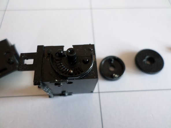

    • disassembly plastic cover
    • unscrew plastic wheel.
    • Becareful not to loose the little metal ball
    • Working on a magnetic mat can be handful
    • when re-assembling:
    • put the first plastic wheel on place
    • Drop the ball in the hole, and put the spring over it
    • Then screw the second plastic wheel over it

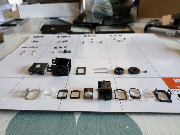

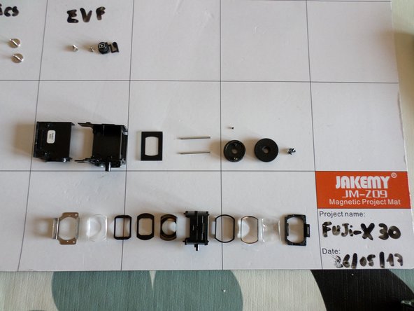

  4. Fujifilm X30  EVF Replacement/Teardown, EVF lens teardown: crwdns2935265:04crwdnd2935265:01crwdnd2935265:03crwdne2935265:0 Fujifilm X30  EVF Replacement/Teardown, EVF lens teardown: crwdns2935265:04crwdnd2935265:02crwdnd2935265:03crwdne2935265:0 Fujifilm X30  EVF Replacement/Teardown, EVF lens teardown: crwdns2935265:04crwdnd2935265:03crwdnd2935265:03crwdne2935265:0
    • To remove lens block, you have to push the 2 metal rods from one side to the other. The rods have one end thinner than the other
    • Now you can remove every lens in order to clean them from dust or humidity
    • When re-assembling, there's only one way to get them back in, so keep track of lenses order and direction when removing each one of them. Or wou'll have to try many times to comlete the puzzle.
