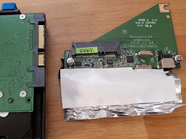

  1. Expansion Teardown, Open the cover: crwdns2935265:01crwdnd2935265:01crwdnd2935265:01crwdne2935265:0
    • Using a flat head screwdriver or plastic tool
  2. Expansion Teardown: crwdns2935265:02crwdnd2935265:01crwdnd2935265:01crwdne2935265:0
    • Remove the cover
  3. Expansion Teardown: crwdns2935265:03crwdnd2935265:01crwdnd2935265:01crwdne2935265:0
    • Remove the drive from the case
  4. Expansion Teardown: crwdns2935265:04crwdnd2935265:01crwdnd2935265:01crwdne2935265:0
    • Peel back the shielding
  5. Expansion Teardown: crwdns2935265:05crwdnd2935265:01crwdnd2935265:01crwdne2935265:0
    • Remove the Screw with the #02 screw driver
  6. Expansion Teardown: crwdns2935265:06crwdnd2935265:01crwdnd2935265:02crwdne2935265:0 Expansion Teardown: crwdns2935265:06crwdnd2935265:02crwdnd2935265:02crwdne2935265:0
    • Separate the adapter form the sata port

This does appear to be a semi-destructive method. In the picture under step 2, you can see the series of plastic brackets on the cover are snapped. See my pictures here
I had difficulty finding a spot to pry up from. There are 4 lips around the cover that should make it easier. See pics.
Derick Roy - crwdns2934203:0crwdne2934203:0
Answering a previous comment: yes, it is possible to replace the drive for one of different size. I replaced on of 3TB for one with 4TB and it is working perfectly.
