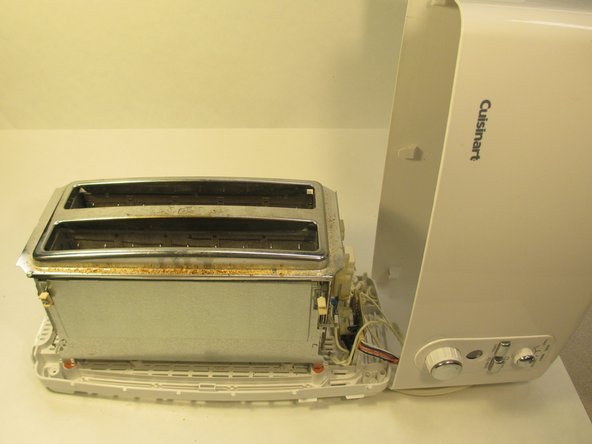

    • Pull the press handle down and away from the toaster to disconnect the body.
    • Lift up the body of the toaster.

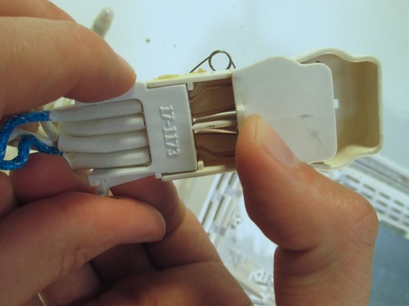

    • Pull the pin header cable to disconnect the body of the toaster from the main assembly unit.
  5. Cuisinart 4-Slice Tandem Toaster Teardown: crwdns2935265:05crwdnd2935265:01crwdnd2935265:03crwdne2935265:0 Cuisinart 4-Slice Tandem Toaster Teardown: crwdns2935265:05crwdnd2935265:02crwdnd2935265:03crwdne2935265:0 Cuisinart 4-Slice Tandem Toaster Teardown: crwdns2935265:05crwdnd2935265:03crwdnd2935265:03crwdne2935265:0

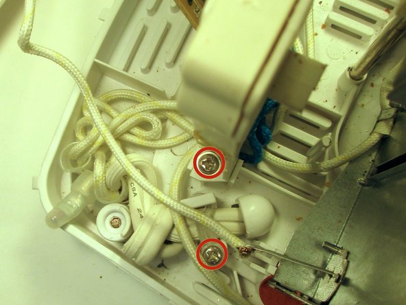

    • Remove the 5 Torx screws to detach the heating unit from the bottom of the toaster unit.

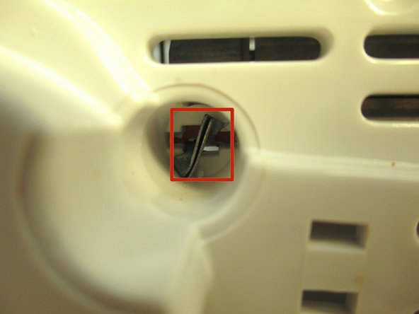

    • Using a plastic opening tool, carefully pry open the metal casing underneath the toaster.

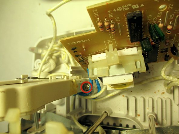

    • Remove the screws to detach controls from the plastic shell of the toaster.

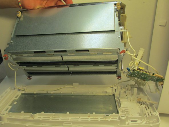

    • Remove the soldered wire that is hooked to each part of the end plate assembly.
  10. Cuisinart 4-Slice Tandem Toaster Teardown: crwdns2935265:010crwdnd2935265:01crwdnd2935265:02crwdne2935265:0 Cuisinart 4-Slice Tandem Toaster Teardown: crwdns2935265:010crwdnd2935265:02crwdnd2935265:02crwdne2935265:0
    • Heating Unit

    • This is the Circuit Board used for controlling each subsystem of the toaster.
    • The integrated circuit marked 4541 contains an oscillator which oscillates at some hundreds or thousands of oscillations per second, the speed being determined by the browning setting. It also contains a binary counter which can count up to 65,536.
    • The integrated circuit marked 4066 contains several logic gates which select the count value required for normal, defrost or reheat.
    • During the count, the logic gates supply a small current to the transistor, causing it to energise the electromagnet. At the end of the selected count, the logic gates switch this current off and the transistor de-energises the electromagnet.
    • While energised, the electromagnet holds the lever down. When the current is switched off the lever is released and the spring pops the toast up.
    • Toasters of this age frequently use these "4000-series" integrated circuits as they can run off a wide range of supply voltages. Newer toasters use a microcontroller (essentially a simple micro computer) as this is more flexible in its functions and can also easily drive LEDs to show you what the toaster is doing.
