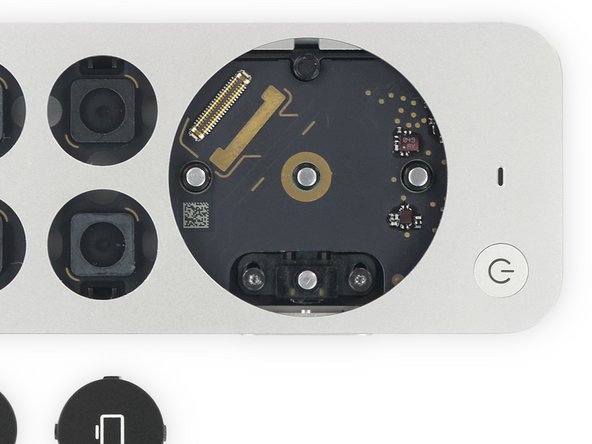

    • That's about it for the black box, but we're not remotely done yet.
    • Starting off with an iPhone-like opening procedure, we remove two P2 Pentalobe screws from the bottom edge of the aluminum wand.
    • On a hunch, we also scoop off the circular clickpad—from there, it's simple to disconnect it from the remote's main board.
  12. Apple TV 4K 2021 Teardown: crwdns2935265:012crwdnd2935265:01crwdnd2935265:03crwdne2935265:0 Apple TV 4K 2021 Teardown: crwdns2935265:012crwdnd2935265:02crwdnd2935265:03crwdne2935265:0 Apple TV 4K 2021 Teardown: crwdns2935265:012crwdnd2935265:03crwdnd2935265:03crwdne2935265:0
    • But when pushing out the interior towards the front (like some iPod mini users may remember), all the buttons are going cross-eyed. So what’s the trick here?
    • For a closer look, we pop off every button like it was 2010 (first appearance of an aluminum remote for the Apple TV).
    • And boy do we find things.

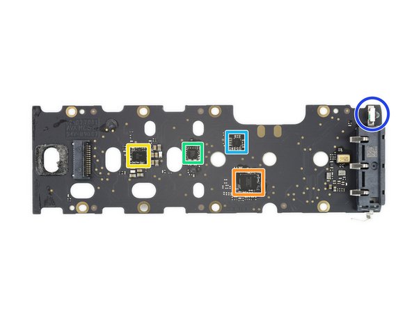

    • … and on the bottom:
    • Analog Devices 343S00092 capacitive touch controller
    • Maxim Integrated MAX77277 power management
    • NXP Semiconductor CBTL1610A3 port controller
    • (e1) AA5 105 (maybe Dialog Semiconductor audio codec)
    • Infrared diode
