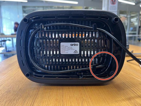

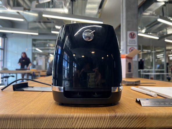

    • Unbox the Toaster or clean up after using in order to begin teardown. Put on Personal Protective Equipment (PPE) such as safety goggles and gloves. Firstly,before disassembling and starting with the teardown make sure the power plug is either unplugged or cut from its body.
    • In this teardown you will need some equipment as you go such as power drills, screwdrivers and a pair of stronghands.

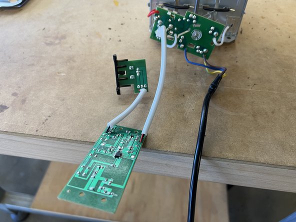

    • Now that most of the toaster's components are revealed we will start with removing the control panels. The control panels or PCB's are located in the upper shell of the toaster where you would usualy push your toast down. These PCB's are simply screwed in with screws. So unscew them and pull them out.
    • Now the top frame can be fully seperated from the bottom frame.

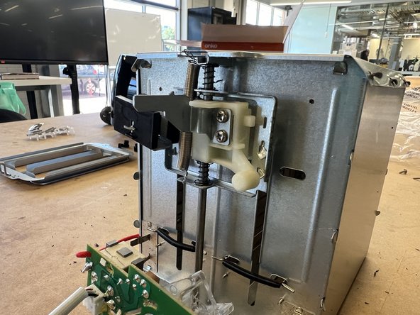

    • Once the Shell Assembly has been removed, move onto the toaster contoll mechanism on the right side. Most of the components are screwed in so unscrew any philips head screws you can see as they all need to be removed.
    • With all of this unscrewing piece by peice parts will come off of the body. Let it be know that many of these parts are made from cheap aluminum metal as it is known for its heat resistance, light weight and cost in manufactuing. What this also means is that parts are easily able to be bent and may need to be bent in removal from the toaster body.

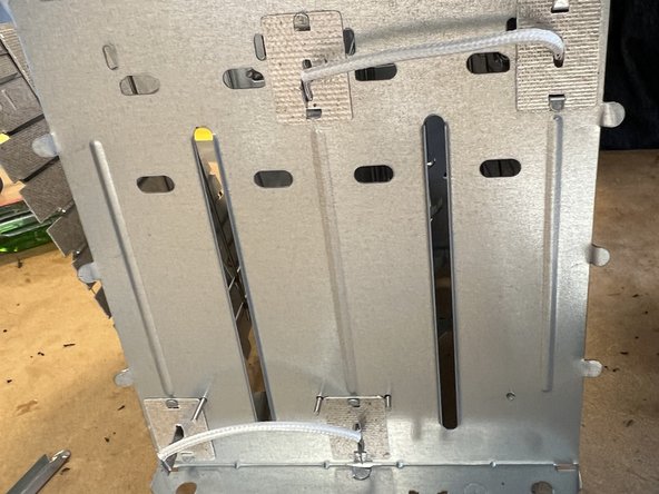

    • Once the loading and operational mechanism on the side has been removed with all the screws. Then cut any remaining wires that are attached to the body or other components. This will then give you full acess to the heating element which is essentaily all manufactured together using press fit components and slotting features.
    • Here is an image of the outerframe of the toaster. Fairly simplistic as all it does is hide the ugly metal components on the inside of the toaster. All of the parts are injection moulded plastic meaning its lightweight while also durable to the effects of moring bread toasting routines.
    • In this step you can see an image of the heating assembly subassembly. These components are all made of thin aluminium sheets for a plethora of reasons. Manufactured using techniques such as lazer cutting, stamping, bending and more.
