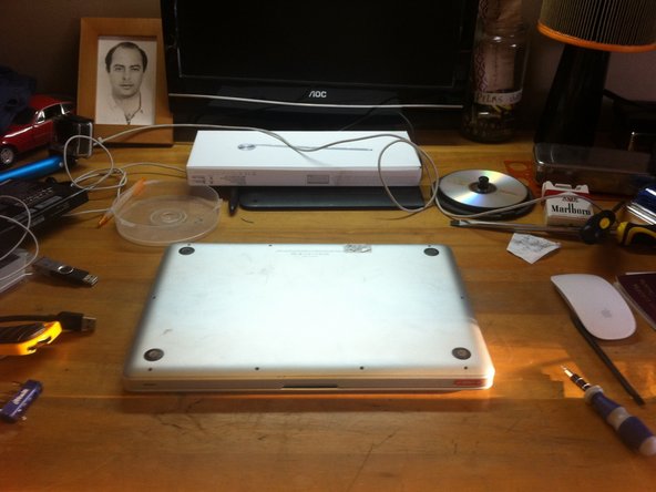

I needed more storage space on my MBP, so i decided to change my actual 500gb HDD for a samsung 840 EVO SSD and with the iFixit dual drive kit, i installed the original 500 gb HDD instead of having the cd/dvd thing that i really never used.
i also recommend if you can, to upgrade your RAM memory, i changed my two 2gb original RAM modules, for two 8gb DDR3 modules, so now my MBP with 2.7 GHz Intel Core i7 processor is running with 16gb of RAM,500gb SSD and 500GB HDD. Now this MBP is way faster than all of my colleagues MBP's!
Extremely friendly and easy, with the iFixit guides is barely impossible that something goes wrong if you follow the instructions as they are meant to be.
is not really necessary to unplug the antenna and internal speaker cables, i didn't and had a single problem, just be sure to be careful enough to not damage this 2 cables.
