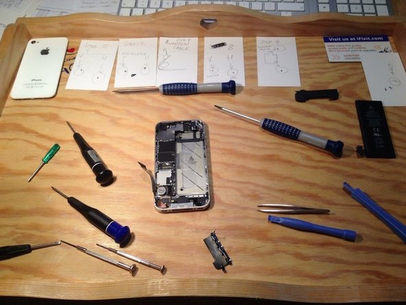

The speakers died... I couldn't hear when someone was calling me or talk to someone via FaceTime unless I used earphones
Perfect! Now it's like a new phone!
Yes! Don't hurry! Work on a big tray, so you wont loose any parts if you drop them. And every screw you take away, put it on a piece of paper and write down where it belongs. It makes it far much easier when you are going to put it together again... :-
