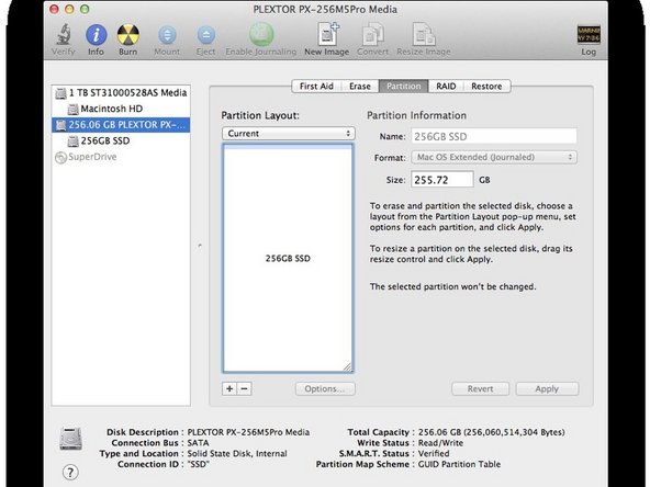

I got the refurbished Mid 2011 21.5" iMac and read about the possibility of creating a FusionDrive with another SSD. Hence, I went to get Plextor PX-5M Pro (256GB) due to its slim 7mm thickness profile, though I believe the usual 9mm thickness should do fine.
