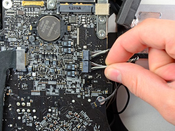

      • Pull the SD board cable out of its socket on the logic board.
    3. Installing iMac Intel 21.5" EMC 2428 Dual Drive Kit: crwdns2935265:024crwdnd2935265:01crwdnd2935265:03crwdne2935265:0 Installing iMac Intel 21.5" EMC 2428 Dual Drive Kit: crwdns2935265:024crwdnd2935265:02crwdnd2935265:03crwdne2935265:0 Installing iMac Intel 21.5" EMC 2428 Dual Drive Kit: crwdns2935265:024crwdnd2935265:03crwdnd2935265:03crwdne2935265:0
      • Disconnect the microphone, left speaker, and right speaker cables by pulling their connectors toward the right side of the iMac.

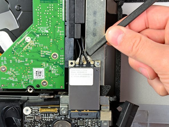

    4. Installing iMac Intel 21.5" EMC 2428 Dual Drive Kit: crwdns2935265:025crwdnd2935265:01crwdnd2935265:02crwdne2935265:0 Installing iMac Intel 21.5" EMC 2428 Dual Drive Kit: crwdns2935265:025crwdnd2935265:02crwdnd2935265:02crwdne2935265:0
      • Use the flat end of a spudger to pry all three AirPort antenna connectors up from their sockets on the AirPort board.
      • During reinstallation, connect the cable with no stripes to the socket marked CH0, the cable with one stripe to CH1, and the cable with two stripes to CH2.

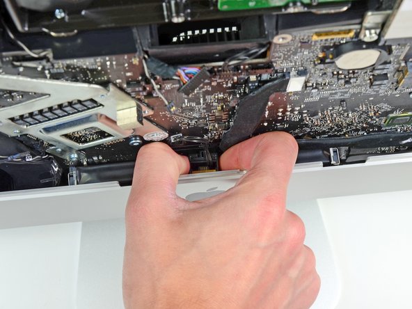

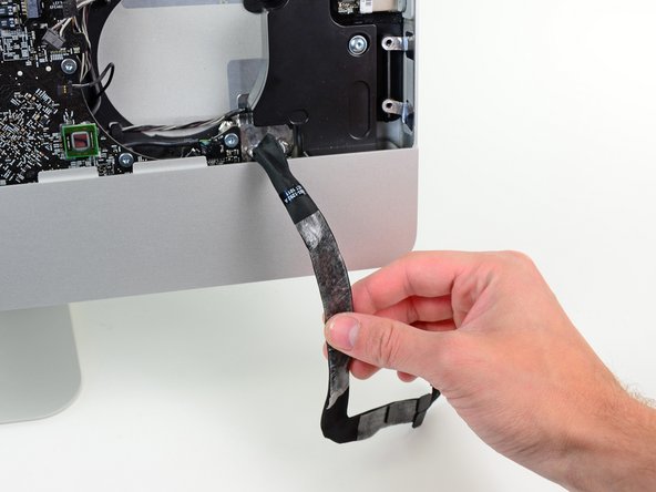

    11. Installing iMac Intel 21.5" EMC 2428 Dual Drive Kit: crwdns2935265:032crwdnd2935265:01crwdnd2935265:02crwdne2935265:0 Installing iMac Intel 21.5" EMC 2428 Dual Drive Kit: crwdns2935265:032crwdnd2935265:02crwdnd2935265:02crwdne2935265:0
      • Pull the audio port cable connector toward the left side of the iMac to disconnect it from the logic board.
      • Do not pull the cable toward yourself (away from the front face of the logic board) as you disconnect it.
      • Peel the audio port cable off the front face of the logic board and let it hang down as shown in the second picture.

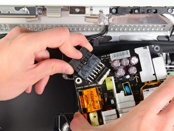

    14. Installing iMac Intel 21.5" EMC 2428 Dual Drive Kit: crwdns2935265:035crwdnd2935265:01crwdnd2935265:02crwdne2935265:0 Installing iMac Intel 21.5" EMC 2428 Dual Drive Kit: crwdns2935265:035crwdnd2935265:02crwdnd2935265:02crwdne2935265:0
      • Carefully lift the power supply out of the outer case and rotate it to expose the cable lock as shown, minding the DC-out and AC-in cables still attaching it to the iMac.
      • Disconnect the DC-out cable by depressing the locking mechanism on the connector while you pull the connector away from its socket on the power supply.
      • Once the locking mechanism has cleared the socket, pull the DC-in connector away from the power supply.
    15. Installing iMac Intel 21.5" EMC 2428 Dual Drive Kit: crwdns2935265:036crwdnd2935265:01crwdnd2935265:01crwdne2935265:0
      • Disconnect the AC-In cable by depressing the locking mechanism while pulling the connector away from its socket.
      • Remove the power supply from the outer case.

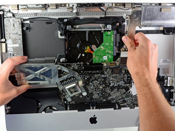

    17. Installing iMac Intel 21.5" EMC 2428 Dual Drive Kit: crwdns2935265:038crwdnd2935265:01crwdnd2935265:02crwdne2935265:0 Installing iMac Intel 21.5" EMC 2428 Dual Drive Kit: crwdns2935265:038crwdnd2935265:02crwdnd2935265:02crwdne2935265:0
      • Slightly pull the logic board away from the back of the outer case, then lift it upward to clear the lower front face of the outer case.

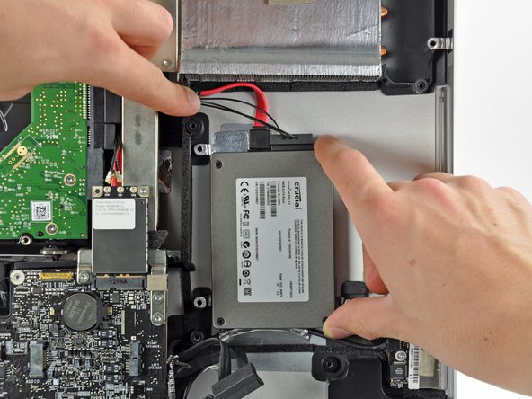

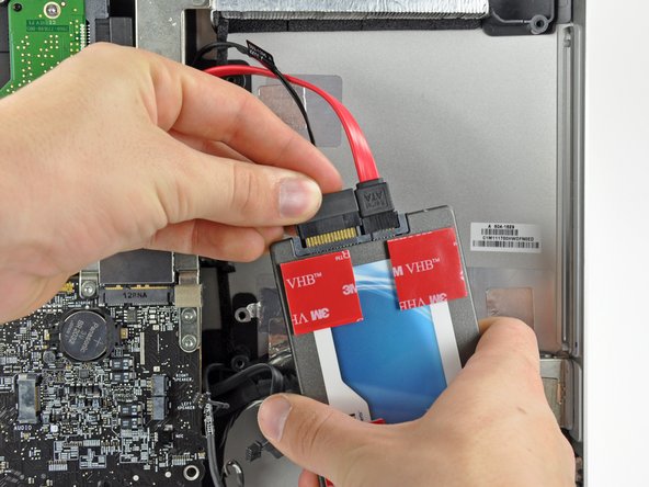

    2. Installing iMac Intel 21.5" EMC 2428 Dual Drive Kit: crwdns2935265:040crwdnd2935265:01crwdnd2935265:01crwdne2935265:0

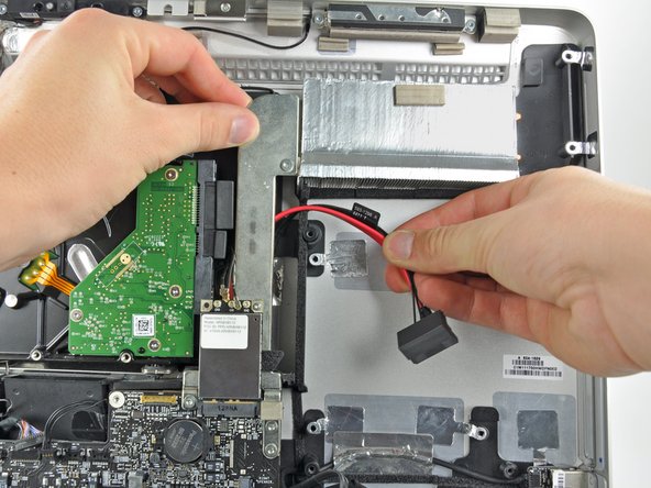

      • First, locate the small connector on the SSD power cable.
    3. Installing iMac Intel 21.5" EMC 2428 Dual Drive Kit: crwdns2935265:041crwdnd2935265:01crwdnd2935265:01crwdne2935265:0
      • Connect the small plug on the SATA power cable to the socket labeled SSD Power on the logic board.
      • The socket is located just below the GPU heat sink.

      • Next, locate the 90º connector on one end of the SATA data cable.
      • The color of your SATA data cable may be different than the cable shown here.

      • Connect the 90º end of the SATA data cable to its socket on the logic board next to the SATA power connector.
    6. Installing iMac Intel 21.5" EMC 2428 Dual Drive Kit: crwdns2935265:044crwdnd2935265:01crwdnd2935265:01crwdne2935265:0
      • With both SATA cables connected, they should look like the logic board shown in the photo.

      • Next, while holding the new hard drive cables against the GPU heat sink, lower the bottom edge of the logic board back down into the outer case.
      • When re-seating the logic board, it is helpful to tape the many connectors that attach to it out of the way to avoid them getting trapped beneath the board.
      • Before pushing the logic board against the back of the outer case, first route the hard drive cables in the channel near the bundle of power cables.
      • As you place the logic board into its recess, route the hard drive cables through the small channel cut into the plastic pressure wall near the fins of the GPU heat sink.
    8. Installing iMac Intel 21.5" EMC 2428 Dual Drive Kit, Installing the Hard Drive: crwdns2935265:046crwdnd2935265:01crwdnd2935265:01crwdne2935265:0
      • In the next few steps, you'll install your new drive into the case of your EMC 2428 iMac.
      • The drive will sit behind the optical drive in the space highlighted in red.

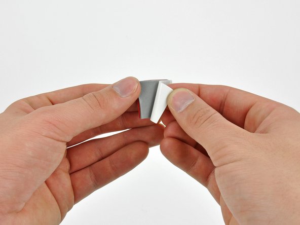

    9. Installing iMac Intel 21.5" EMC 2428 Dual Drive Kit: crwdns2935265:047crwdnd2935265:01crwdnd2935265:03crwdne2935265:0 Installing iMac Intel 21.5" EMC 2428 Dual Drive Kit: crwdns2935265:047crwdnd2935265:02crwdnd2935265:03crwdne2935265:0 Installing iMac Intel 21.5" EMC 2428 Dual Drive Kit: crwdns2935265:047crwdnd2935265:03crwdnd2935265:03crwdne2935265:0

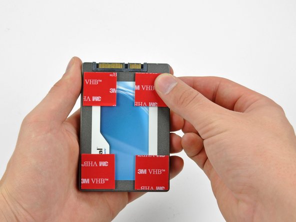

      • To secure your new drive in your iMac, you will need to place high strength double-sided tape at the four corners on the side of the drive with the SATA connectors.
      • Peel the backing off one side of the double-sided tape and place the pieces at the four corners of the hard drive.
    10. Installing iMac Intel 21.5" EMC 2428 Dual Drive Kit: crwdns2935265:048crwdnd2935265:01crwdnd2935265:02crwdne2935265:0 Installing iMac Intel 21.5" EMC 2428 Dual Drive Kit: crwdns2935265:048crwdnd2935265:02crwdnd2935265:02crwdne2935265:0
      • Connect both the SATA data and SATA power connectors to your new hard drive.
      • The SATA connectors will be nearest the top of the iMac when the hard drive is installed.
    11. Installing iMac Intel 21.5" EMC 2428 Dual Drive Kit: crwdns2935265:049crwdnd2935265:01crwdnd2935265:02crwdne2935265:0 Installing iMac Intel 21.5" EMC 2428 Dual Drive Kit: crwdns2935265:049crwdnd2935265:02crwdnd2935265:02crwdne2935265:0
      • Remove the backing from the double-sided tape and place the hard drive inside the iMac.
      • Carefully set the drive into the iMac optical bay as close to the lower left corner as possible.
      • Do not to repeatedly stick and un-stick the tape, as the adhesive will become weaker.
      • Once you are happy with the hard drive's placement, firmly press down along its edges to ensure full adhesion.

It should be noted to anyone doing this that RAM should be removed first. When you get towards the end things go bad if your RAM is still in there and you start moving the mainboard around.
azkaban1 - crwdns2934203:0crwdne2934203:0 crwdns2950251:0crwdne2950251:0
You are correct. I followed the ifixit guide on youtube and it was not mentioned to remove the RAMs. But in fact the RAMs should be removed in order to pull the logic board.
Mohamed Kamal - crwdns2934203:0crwdne2934203:0 crwdns2950251:0crwdne2950251:0
Seconded ... remove ram first! Spent more time reinstalling main board than anything else.

Tool me about two hours to do, had to have my brother help me when i was removing the logic board and screen.
Found that the logic board was extreamly hard to remove.
Good tip is to selotape the cables before removing / inserting the logic board as i traped my microphone connector underneath. Luckely i could reach it with a pair of tweesers.

Can anybody explain why the PSU module needs to be removed (steps 34-37)? I saw a similar guide elsewhere and it skipped this completely. Is this not required? If so, that might explain why this guide says that to re-assemble do the reverse from step 33 and not 38 as expected!
