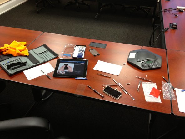

User dropped brand new iPhone 4S after removing case...
Repair took about an hour and a half. Wish I had the magnetic parts mat or tray of some kind. Drew boxes on a piece of paper putting parts from each step inside. Replacement went well, product worked as expected afterwards.
- Used the Pro Tool Set - couldn't have done it without.
- Front glass is also glued / taped in place. Had to use the steel pry bar to get the glass off the case.
- Be patient!
