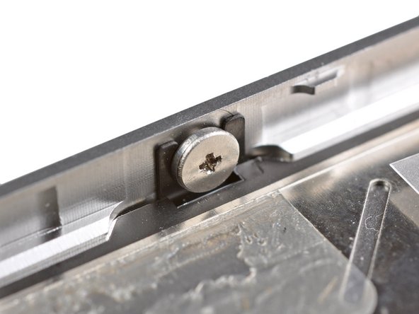

    1. iPhone 4S Screen Replacement, Screen: crwdns2935265:032crwdnd2935265:01crwdnd2935265:01crwdne2935265:0
      • Remove the small pieces of black tape covering the display mounting tabs.
      • Note: These corner screws are not the same thickness as the other 1.5mm screws. Set them aside separately.

    6. iPhone 4S Screen Replacement: crwdns2935265:037crwdnd2935265:01crwdnd2935265:02crwdne2935265:0 iPhone 4S Screen Replacement: crwdns2935265:037crwdnd2935265:02crwdnd2935265:02crwdne2935265:0
      • Loosen the three large-headed Phillips screws along the volume button side of the iPhone about one half turn.
      • It is not necessary to completely remove these screws. When reinstalling the display assembly, be sure the washers are closest to the screw head (as seen in the second picture).
    7. iPhone 4S Screen Replacement: crwdns2935265:038crwdnd2935265:01crwdnd2935265:01crwdne2935265:0
      • Loosen the three large-headed Phillips screws along the other side of the iPhone about one half turn.
