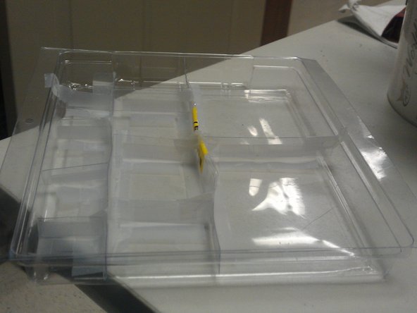

3. Get or make a tray to hold all the screws and small parts. ( there are a ton of them). I made one out of a plastic hard drive case and some scotch tape. lol. it is a bit ugly but works very well. ( picture attached)
