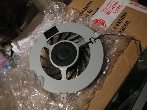

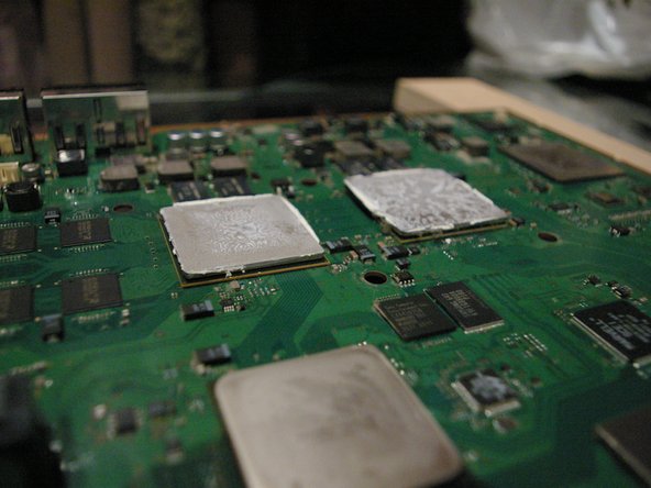

A YLOD failure, before the holidays, meant drastic measures were required. I found ifixit in my research, and took the plunge. I had torn down PS2s before, but this would be my first tear down of a PS3 (the most I'd done was to upgrade the HD to a WD 320GB). BF3 was on my gift list, and I was determined not to have a YLOD prevent me from playing BF3.
I was very meticulous, took my time, and upgraded the 15-blade CPU fan to a 19-blade one. Wished the ifixit kit came with all the types of tape used within the PS3, as it can become unstuck or have lost its stickiness. This fix lasted a little over two months of heavy weekend use. It also allowed me to perform a complete backup to an external hard drive.
I will now restore my backup to a new PS3 Slim 320GB.
If you still have a FAT 60GB PS3 that works, backup your drive right now, and get the YLOD ifixit kit. In my case it gave me a little over two months of additional use, and allowed me to perform my backup,
