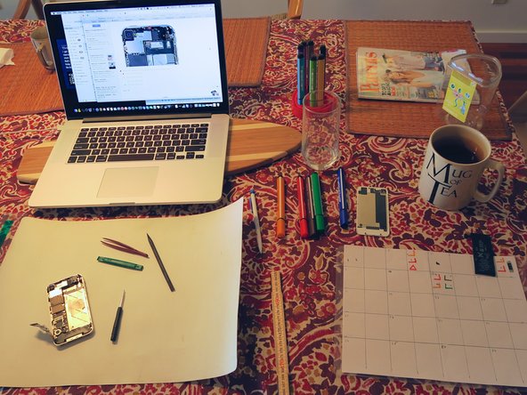

The phone had no apparent damage, but the screen had vertical stripes moving like northern lights. Sometimes it was possible to read the screen after a 5-10 min.
The package arrived as promised. I used the online step by step guide. Great photos and color coding. Made a piece of paper with 40 squares numbered 1-40. I would put the screws etc from step 1 on square 1 and so forth. Had some colored pens to make colored corners to follow the color coding in the guide, red screw in red corner... This was my first Iphone repair so I was VERY meticulous, and probably spend 2 hrs 30 min on the project, nothing difficult just a lot of very tiny screws and bits....
DON'T save the pennies, but get the assembly kit, made my life so much easier. Take your time.....
