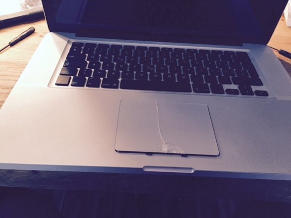

The Trackpad's glasse was broken and the clic not working. I decide to change the complete Trackpad with a new one.
I just followed the procedure of ifixt and replaced the broken one with the new one. It's perfectly woring.
Take the time to clean up the fans and the dust of the motherboard. Important : Before to screw the battery, adjust the trackpad click with the screw to have good feeling.
